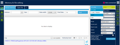

I'm working with STM32F429ZI nucleo board, and I would like to flash my program using UART (USART1 or UART3 via  a usb to ttl converter)  instead of ST-Link.I understand that STM32 has a built-in bootloader that can be used for flashing via UART, but I'm not sure about the exact steps or tools required.
when I connect the uart  with  STM32CubeProgrammer an error message come :-
13:58:51:175 : Error occured while sending Init command.
13:58:51:175 : Error: Activating device: KO. Please, verify the boot mode configuration and check the serial port configuration. Reset your device then try again......

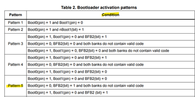

Hello @Asha1 ;
As mentioned in AN2606, the STM32F42xxx/43xxx bootloader is activated by applying Pattern 5. So, you need to satisfy the below condition.
I recommend you to look at this STM32 boot and startup tips - 2 Embedded bootloader investigations Mooc and get inspired. This video provides a step-by-step guide.
I hope help you.
Thank you.

Shirley.Ye
3. What software can I use on the PC side (e.g., STM32CubeProgrammer or any alternatives)?
STM32CubeProgrammer can be used. choose uart, and connect.
4. What file format should I use (.hex or .bin)?
both .hex or .bin can be used.
