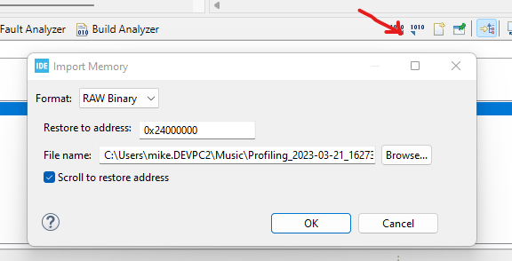

How to fill RAM locations during debug
  • March 23, 2023
  • 1238 views
I need to fill certain RAM (buffer) locations with known values (i.e. compressed audio) during a CubeIDE debug session. I thought there was a way to load values into RAM while the program was stopped at a breakpoint. But I can't seem to find this tool. Seems like it existed in Atollic, but can't find it in CubeIDE. Any thoughts?
Thx,
MikeH
    Best answer by KnarfB
    In the Debugger Console view you can enter a command
    restore mydatafile.bin binary 0x20001000
    to load it to the address specified.
    hth

    Thanks KnarfB Found it.
