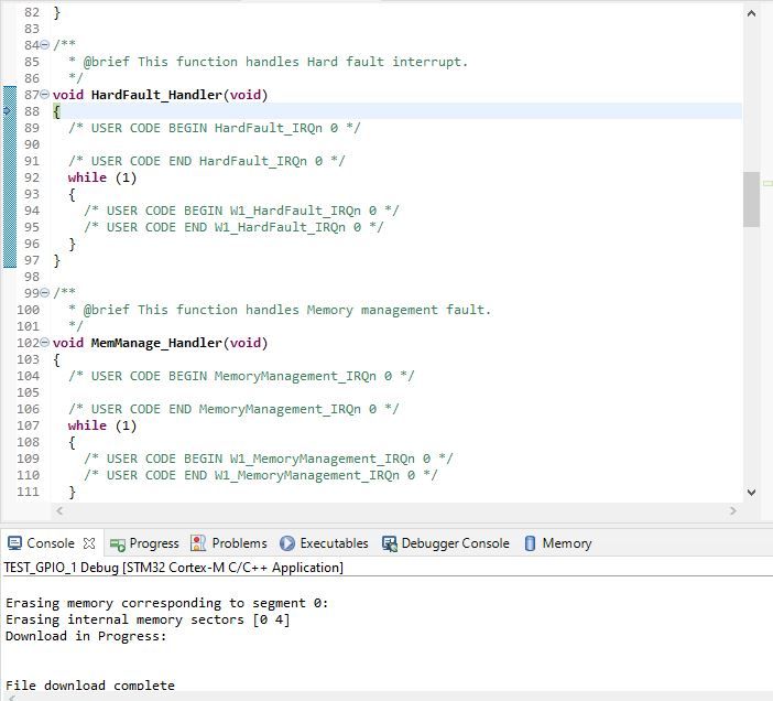

I am trying to collect data from ADC using DMA in circular buffer mode.
i want to excess/read DMA_SxNDTR register. also tell me how to read data from circular buffer. I have written code for reading count from DMA_SxNDTR but it is not working , it is going to "void HardFault_Handler(void)" and stop there.i have attached screenshot.

waclawek.jan
Which STM32?
> uint16_t * DMA_count;
Note, that usually DMA registers can be accessed only as 32-bits.
Normally, you would read the NDTR's value by
k = DMA1_Stream0->NDTR;
