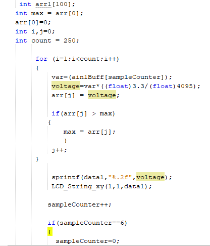

I have connected a sine wave of amplitude 3V with 1.5V shifted above the zero to 12-bit ADC channel by using dsPIC33FJ32MC204 controller and stored in an array. I want to detect the max value out of five samples because after the five samples my data is repeating, so please give me any suggestion on it. I am getting output as a zero.

The code you want to write will never fill the array completely because
Each time i will be 0​
You have take another variable for the loop to do by your way
​array[i] =adc_value;​
     for(j=0;j<8;j++)
     if(array[j] > max)
     max = array[j];
sprintf(data1,"%.2f",max);
LCD_String_xy(1,1,data1);
max=0;
i++;​
     if(i == 8)
      i = 0;
This will work​

@sanju​ Thanks for your quick response sir and your logic is working properly and getting max value accurately but facing one problem that as data is real time ,so how can i take infinite data in array means how can i update array values with ADC values?

@sanju​ Thanks for your reply sir. I have to detect max value in both cases (i<arrayLength & i == arrayLength ),but in one condition i.e i<arrayLength max value detection is missing. And another thing is can i replace the whole code by writing the code like-

@sanju​ I got your point sir but once j becomes greater than 8,it will never goes in for loop and my data is real time data, so I have to do it continuously. I think instead of i = 0, it should be j = 0 ?
Dear Mohan,
j is running a loop
i.e. for(j=0;j<8;j++)
so if j>8, your code is in while loop, so every time j will be initialized with j=0 to start the loop.
i and j are separately working i is filling array and j is finding max value by running a loop
@sanju​ Now everything is cleared sir, thank you and special thanks to your patience for clearing my basic doubts.
