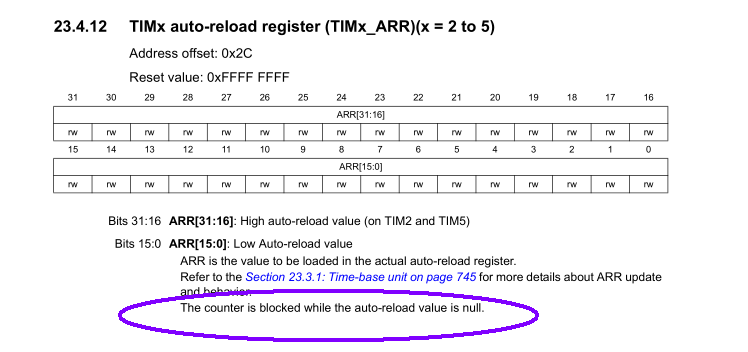

I think your first statement is untrue.
I can't find anything on the documentation preventing the ARR register to be 0.
I've found the above equation:
Interrupt Period = (PSC+1)*(ARR+1) / TmerClockFreq
Do you have any references on that? I haven't found anything about this online.
The Prescaler can be zero (DIV1), setting Period to zero basically disables the count.
The TIM effectively acts as a pair of dividers.
UPDATE FREQ = (TIMCLK / (PSC+1)) / (ARR+1)
or
UPDATE FREQ = TIMCLK / ((PSC+1) * (ARR+1))
For N-states, the counter goes from 0 thru N-1
In silicon making a comparator for N-1 is easier, as you can flag that the next state will be zero. You don't want to wait to get to N and then react.
