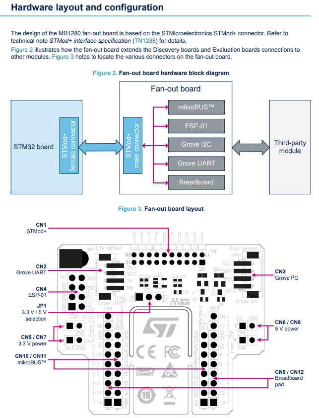

_legacyfs_online_stmicro_images_0693W00000bk0g7QAA.pngESP-01 is supported on fanout expansion board, how to connect WIFI and send message in local area network? Is there any example?

AScha.3
May 13, 2023
no PC - just serial connection. read the manual, whats serial connected from H747 to CN4 . should be a usart or uart.
_legacyfs_online_stmicro_images_0693W00000bk0qWQAQ.pngthen send serial commands...thats it.
commands:
https://pridopia.co.uk/opencart/pi-doc/ESP8266ATCommandsSet.pdf
you can look at arduino examples, how to do...if you have no own ideas.
https://wolles-elektronikkiste.de/esp8266-esp-01-modul
