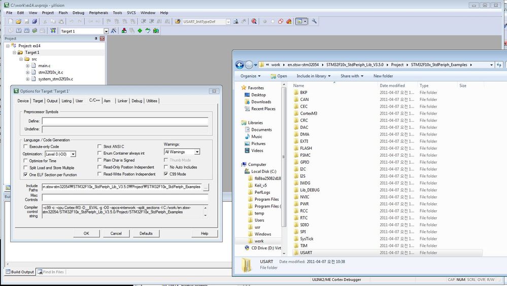

Currently I'm struggling with building up the project with SPL library in Keil.
For example, I'd like to use USART's Interrupt example.
C:\work\en.stsw-stm32054\STM32F10x_StdPeriph_Lib_V3.5.0\Project\STM32F10x_StdPeriph_Examples\USART\Interrupt
and I add codes and set up the include directory.
But I got still error messages what there is missing define.
Could you please how to resolve this problem?
and I've attached project file. ex14.7z

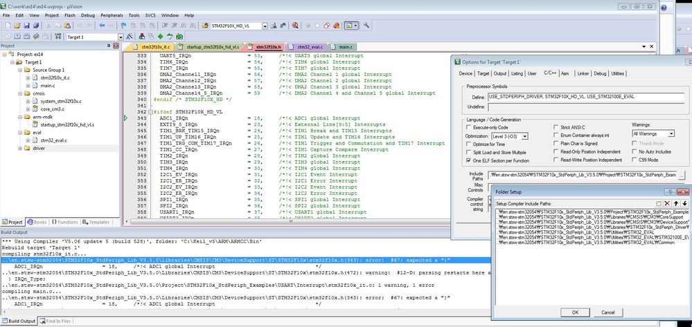

Thanks Clive, But I'm still struggling with build up the project even I refer the template project.
the error message is the below
can you help me what am I supposed to do?
*** Using Compiler 'V5.06 update 5 (build 528)', folder: 'C:\Keil_v5\ARM\ARMCC\Bin'
Rebuild target 'Target 1' compiling stm32f10x_it.c... ..\en.stsw-stm32054\STM32F10x_StdPeriph_Lib_V3.5.0\Libraries\CMSIS\CM3\DeviceSupport\ST\STM32F10x\stm32f10x.h(343): error: #67: expected a ''}'' ADC1_IRQn = 18, /*!< ADC1 global Interrupt */ ..\en.stsw-stm32054\STM32F10x_StdPeriph_Lib_V3.5.0\Libraries\CMSIS\CM3\DeviceSupport\ST\STM32F10x\stm32f10x.h(472): warning: #12-D: parsing restarts here after previous syntax error } IRQn_Type; ..\en.stsw-stm32054\STM32F10x_StdPeriph_Lib_V3.5.0\Project\STM32F10x_StdPeriph_Examples\USART\Interrupt\stm32f10x_it.c: 1 warning, 1 error compiling main.c... ..\en.stsw-stm32054\STM32F10x_StdPeriph_Lib_V3.5.0\Libraries\CMSIS\CM3\DeviceSupport\ST\STM32F10x\stm32f10x.h(343): error: #67: expected a ''}'' ADC1_IRQn = 18, /*!< ADC1 global Interrupt */ ..\en.stsw-stm32054\STM32F10x_StdPeriph_Lib_V3.5.0\Libraries\CMSIS\CM3\DeviceSupport\ST\STM32F10x\stm32f10x.h(472): warning: #12-D: parsing restarts here after previous syntax error } IRQn_Type; ..\en.stsw-stm32054\STM32F10x_StdPeriph_Lib_V3.5.0\Project\STM32F10x_StdPeriph_Examples\USART\Interrupt\main.c: 1 warning, 1 error compiling system_stm32f10x.c... ..\en.stsw-stm32054\STM32F10x_StdPeriph_Lib_V3.5.0\Libraries\CMSIS\CM3\DeviceSupport\ST\STM32F10x\stm32f10x.h(343): error: #67: expected a ''}'' ADC1_IRQn = 18, /*!< ADC1 global Interrupt */ ..\en.stsw-stm32054\STM32F10x_StdPeriph_Lib_V3.5.0\Libraries\CMSIS\CM3\DeviceSupport\ST\STM32F10x\stm32f10x.h(472): warning: #12-D: parsing restarts here after previous syntax error } IRQn_Type; ..\en.stsw-stm32054\STM32F10x_StdPeriph_Lib_V3.5.0\Project\STM32F10x_StdPeriph_Examples\USART\Interrupt\system_stm32f10x.c: 1 warning, 1 error compiling core_cm3.c... assembling startup_stm32f10x_hd_vl.s... compiling stm32_eval.c... ..\en.stsw-stm32054\STM32F10x_StdPeriph_Lib_V3.5.0\Libraries\CMSIS\CM3\DeviceSupport\ST\STM32F10x\stm32f10x.h(343): error: #67: expected a ''}'' ADC1_IRQn = 18, /*!< ADC1 global Interrupt */ ..\en.stsw-stm32054\STM32F10x_StdPeriph_Lib_V3.5.0\Libraries\CMSIS\CM3\DeviceSupport\ST\STM32F10x\stm32f10x.h(472): warning: #12-D: parsing restarts here after previous syntax error } IRQn_Type; ///// ... ............//// ..\en.stsw-stm32054\STM32F10x_StdPeriph_Lib_V3.5.0\Libraries\CMSIS\CM3\DeviceSupport\ST\STM32F10x\stm32f10x.h(472): warning: #12-D: parsing restarts here after previous syntax error } IRQn_Type; ..\en.stsw-stm32054\STM32F10x_StdPeriph_Lib_V3.5.0\Libraries\STM32F10x_StdPeriph_Driver\src\stm32f10x_usart.c: 1 warning, 1 error compiling stm32f10x_wwdg.c... ..\en.stsw-stm32054\STM32F10x_StdPeriph_Lib_V3.5.0\Libraries\CMSIS\CM3\DeviceSupport\ST\STM32F10x\stm32f10x.h(343): error: #67: expected a ''}'' ADC1_IRQn = 18, /*!< ADC1 global Interrupt */ ..\en.stsw-stm32054\STM32F10x_StdPeriph_Lib_V3.5.0\Libraries\CMSIS\CM3\DeviceSupport\ST\STM32F10x\stm32f10x.h(472): warning: #12-D: parsing restarts here after previous syntax error } IRQn_Type; ..\en.stsw-stm32054\STM32F10x_StdPeriph_Lib_V3.5.0\Libraries\STM32F10x_StdPeriph_Driver\src\stm32f10x_wwdg.c: 1 warning, 1 error ''.\Objects\exaxf'' - 27 Error(s), 27 Warning(s). Target not created. Build Time Elapsed: 00:00:29 ________________ Attachments : ex14_9_5.zip : https://st--c.eu10.content.force.com/sfc/dist/version/download/?oid=00Db0000000YtG6&ids=0680X000006HySL&d=%2Fa%2F0X0000000b7z%2F2QBIdBoPPt69nnp_rkxw1bWyUu.F0JyNuxeDKvD9nDE&asPdf=false
