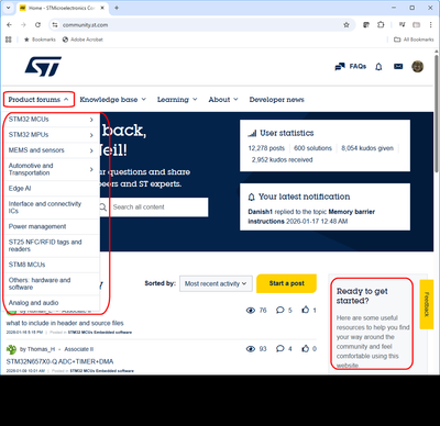

Here's the list of STM32 forums:
For questions specifically about ST's boards, use STM32 MCUs Boards and hardware tools
For questions about ST software, use STM32 MCUs Embedded software
etc.

You can see the full list of forums by clicking on 'Product Forums' at the top of the page:

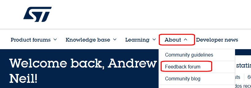

For questions/comments about the forum itself, use the Feedback forum - via the 'About' menu:
