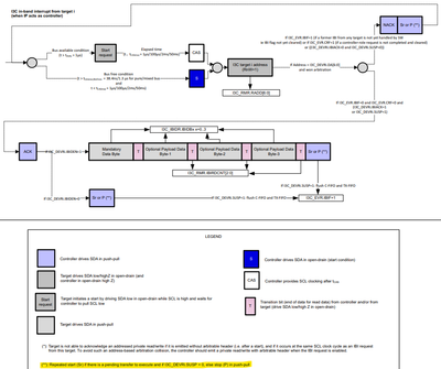

I find two things in RM0492 that may be helpful for my question: One is in Figure 418, there is the following note with 2 asterisks :Repeated start (Sr) if there is a pending transfer to execute and if I3C_DEVRi.SUSP = 0, else stop (P) in push-pull.

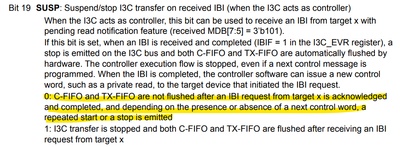

The other is that there is a register called I3C device x characteristics register in RM0492. Here is the following description in RM0492, I set bit19 SUSP to 0, so that C-FIFO and TX-FIFO are not flushed after an IBI request.
Based on this description, I preload a private read with C-FIFO before IBI, but I still saw that IBI completes with STOP, and then a START with private read. Is it possible to generate a repeated start after an IBI request? Does Hardware support for this sequence?

The pending read IBI always ends with STOP. The software then needs to program a read to the target that requested the pending read. No possibility to have a RESTART between the IBI and the private read.
