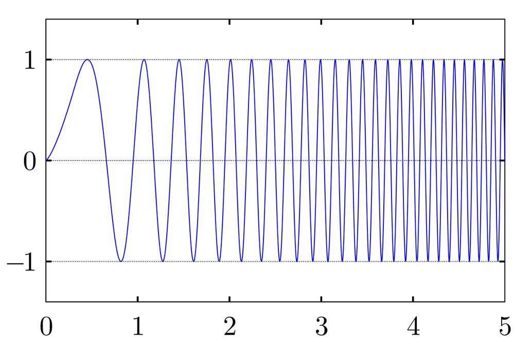

If you need it to be super smooth, the easiest way to do this is to generate new DAC values as you go. Use the HT and TC interrupts to signal that the first and second half of the buffer needs new values and populate them on the fly. Leave the update time alone.

Say you want a sine wave.
y = sin(t / w)
(where w is frequency)
You can generate this incrementally:
y0 = sin(t0 / w) -->
y1 = sin((t0 + dt) / w)
So inside your sine function, the angle changes by dt / w at each increment.
If you want w to vary linearly, say
w(t) = w0 + dw * t
Then you generate your new values as such
theta0 = 0
y0 = sin(theta0)
theta1 = theta0 + dt * w(0) = theta0 + dt * w0
y1 = sin(theta1)
theta2 = theta1 + dt * w(dt) = theta1 + dt * (w0 + dw * dt)
y2 = sin(theta2)
theta3 = theta2 + dt * w(dt) = theta1 + dt * (w0 + 2 * dw * dt)
y3 = sin(theta3)
Basically increment the angle for each data point, but change how much it increments based on the current frequency at that point.
