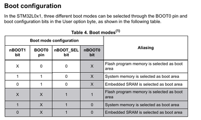

I read something that when I use NRST pin to reset manually then the pins GPIO are automatically assigned as SWD but I could read it anywhere in Reference Manual typing NRST. I only found how BOOT works which I also don't understand what do these modes mean like selecting boot area ... :

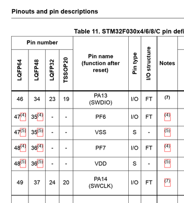

The answer to your questions is simple :
just think, how would you build a cpu, that can be programmed/accessed after power-up or reset in any way ?
Right - the needed pins start with this function enabled after power-up; otherwise you could never access the cpu - right ?
see ds : (here from F030)
Until you change the pin functions in your program, they will do the "function after reset" .
See detail for your chip in ds, different series have different settings here.

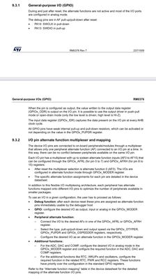

Dear @Xenon02 ,
You can go to GPIO chapter inside the reference manual on how the Alternate functions are working and therefore how to configure them . Here
https://www.st.com/resource/en/reference_manual/rm0376-ultralowpower-stm32l0x2-advanced-armbased-32bit-mcus-stmicroelectronics.pdf#page235
NRST pin if connected to your debugger (ST-Link for instance) is a way to force a hardware reset and pull the line low synchronized with the debug so it can enter debug mode and send the right commands there SWD protocol to take control of the CPU. This is very useful when customer applications is entering STOP mode as soon as the CPU is starting or theses two pins PA14/PA13 are configured to others peripherals . So I would recommend in your case to route NRST to your debugger to have 4 lines including ground . SWD protocol has also a SOFT reset and can send it to the CPU.
Hope it helps you .
