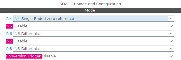

I'm trying to make 16-bit ADC measurement works but I have some trouble understanding the argument Channel.
First I have these SD-ADC channels.
0693W000006EzhIQAS.png0693W000006GXNdQAO.pngSDADC1 have:
  • IN4 = Single zero reference
  • IN6 = Differential
  • IN8 = Differential

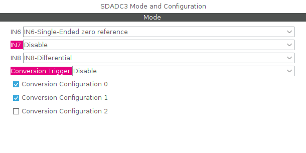

SDADC3 have:
  • IN6 = Single zero reference
I have study this example and do the same thing as the example does:
https://github.com/STMicroelectronics/STM32CubeF3/blob/8fa3aadf0255818f0ca72ba6a5a6731ef8c585fb/Projects/STM32373C_EVAL/Examples/SDADC/SDADC_Voltmeter/Src/main.c
Yes, it works. But I have 5 measurements, not 1 measurement as the example shows.
I have created a call-back function for the NVIC interrupts for the SDADC's.
But still, I cannot get a stable value, because I'm indexing in wrong channel. Do you know how to do this?
Should I start with
CHANNEL = 0;
Or what should I do?
uint32_t CHANNEL
void HAL_SDADC_InjectedConvCpltCallback(SDADC_HandleTypeDef *hsdadc){
	if(hsdadc->Instance == SDADC1){
		// SD ADC 1
		if(CHANNEL == 4)
			SD_ADC_VALUES[0] = HAL_SDADC_InjectedGetValue(hsdadc, &CHANNEL);
		else if(CHANNEL == 8)
			D_SD_ADC_VALUES[0] = HAL_SDADC_InjectedGetValue(hsdadc, &CHANNEL);
		else if(CHANNEL == 6)
			D_SD_ADC_VALUES[1] = HAL_SDADC_InjectedGetValue(hsdadc, &CHANNEL);
	}else if(hsdadc->Instance == SDADC3){
		if(CHANNEL == 6)
			D_SD_ADC_VALUES[2] = HAL_SDADC_InjectedGetValue(hsdadc, &CHANNEL);
