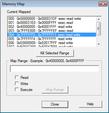

In Keil uvision I can define a memory region by using MAP command.
MAP 0x3FFFFB44,0x3FFFFFF8 read write
Or
I could use the Memory Map dialog from Keil ''Debug'' dropdown.
However, what should I do to specify the memory region in actual hardware (in my case STM32F103RB)?
Is there a way to specify a memory region in STM32 ST-LINK Utility software before burning code in my stm32 microcontroller?
NOTE:
I want to be able to read/write in a memory region from 0x3FFFFB44,0x3FFFFFF8 which is inaccessible. Everything works fine in Keil Simulator after I add this memory region range in Memory Map dialog. What should I do to be able to access this region in actual hardware?

Posted on June 08, 2018 at 20:59
You don't get to define this, you can add external memory to STM32 devices via the FSMC/FMC bus, but the decode addresses are fixed by the hardware, no doubt described in the Reference Manuals
On the STM32F1 your FLASH memory is situated at 0x08000000 and the SRAM at 0x20000000, with the peripherals up at 0x40000000
In your compiler/linker settings you should specify the memory map the code needs to use

Posted on June 09, 2018 at 16:40
>>Now at this point, I don't need to specify memory manually inside
Memory Map dialog, Right?
You're telling the linker where it can place things, not sure that's the same thing you were doing with the Simulator
>>When I run the program it still gives me the access violation at 0x3FFFFB44. Am I configuring the Flash.ld file correctly?
The .LD describes what you want the linker to do.
The STM32F1 still doesn't have any memory in that region, and generates a fault because you access something that doesn't exist.
This memory space is a fiction of your imagination, it doesn't exist in reality. The silicon design in the chip does not include it.
While the chip has a notional 4GB address space (0.. 0xFFFFFFFF) there are large holes in that.
