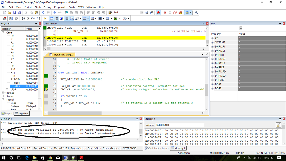

Keil uvision4 does not allow to read/write to DAC registers of STM32F103RB. What should I do?

Use real hardware, Error 65 indicates the feature/register is not supported by the *simulator*

Read the datasheet to see why it is accessible?
