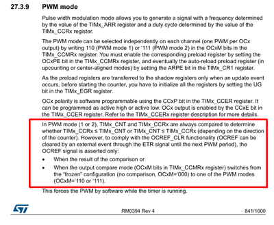

While solution is - as TDK said above - to change the compare mode to one of the "always active/inactive"; or, maybe even simpler, change given pin in GPIO_MODER from AF to Out; changing CNT in stopped timer indeed may not result in the expected change.
The description of PWM mode as "high when < CCRx and low when > CCRx" is somewhat simplistic. As so often ST, instead of giving a precise description of given subcircuit (and as timing diagram or schematics instead of narrative, where appropriate), it just gives a dumbed down description of "what usually happens", assuming that the audience is too *** to comprehend the grand picture.
Here's the hint of what really happens:

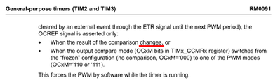

Now, characteristically to the state of documentation, there is one word missing, making it incomprehensible. Here's the same description from an older STM32 family:
Also characteristically, this narrative is missing from TIM1/TIM15 etc. chapter, where the picture is probably even more complex (and not described properly/fully either).
Note that what comparison is performed depends on direction; and even if it is not said there, that's not the full picture and truth is that changing CNT in the opposite direction simply has no effect. Most probably, the comparator can only set OCREF and it's cleared by Update (or opposite polarity given by PWM mode etc.)
