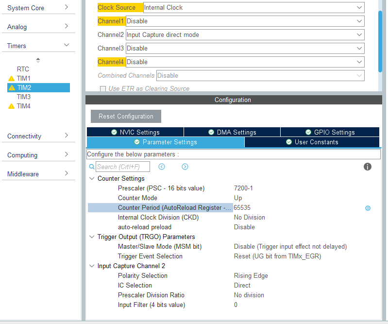

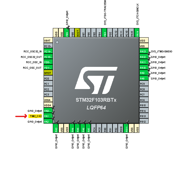

Hi
I measure the frequency from sensor using the Timer Input Capture mode.
I set the timer can read minimum 1Hz.
72M / 7200/65535 = 0.15Hz
This is my code.
void HAL_TIM_IC_CaptureCallback(TIM_HandleTypeDef *htim)
HAL_GPIO_WritePin(LED_PORT, IN_LED_PIN, GPIO_PIN_SET);
if (Is_First_Captured == 0)
IC_Value1 = HAL_TIM_ReadCapturedValue(&htim2, TIM_CHANNEL_2);
//TIM2->CNT = 0;
tim2_ovc = 0;
Is_First_Captured = 1;
else if (Is_First_Captured)
IC_Value2 = HAL_TIM_ReadCapturedValue(&htim2, TIM_CHANNEL_2);
if (IC_Value2 > IC_Value1)
Period = IC_Value2 - IC_Value1;
else if (IC_Value2 < IC_Value1)
Period = (htim2.Instance->ARR - IC_Value1) + IC_Value2;
freq = (HAL_RCC_GetPCLK2Freq() * 2)/(htim2.Instance->PSC + 1);
Frequency = freq/Period;
Is_First_Captured = 0;
But It can't measure the frequency. (When input frequency 1Hz,..)
What's wrong my code and setting?
Please help me..:sad_but_relieved_face:
