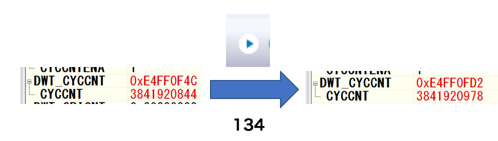

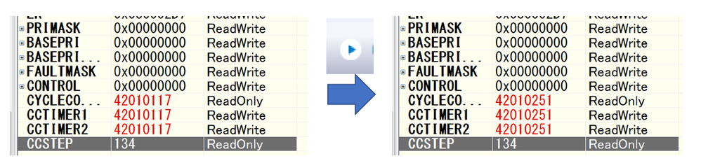

Thank you for your reply. I found
CYCLECOUNT register. I enabled the CYCLECOUNT register by setting the DWT Control register's CYCNTENA bit (DWT_CTRL.CYCNTEN) to 1.

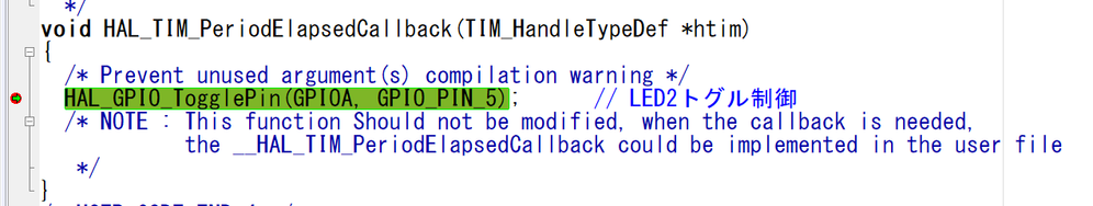

But I have something I can not understand. I made a program that flashes the LED by TIM counter overflow every 500 ms. Below is the interrupt part of the program. I set a breakpoint here.
And as shown in the picture below, I was able to get CCSTEP = 134.

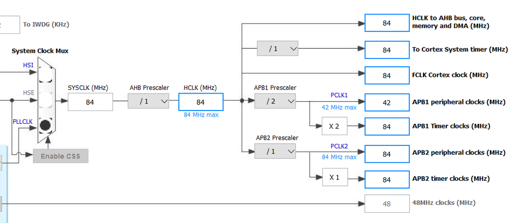

But what does this 134 mean? I am using STM32F401RETx Nucleo-F401RE, and SYSCLK is 84MHz.
So, 134/(84*10^6)=1.595us. I want this answer to be 500 ms.
Best Regards,
Ken Inoue

Thank you for your reply. First, I would like you to see my answer to Mr./Ms.KIC 8462852 EPIC 204278916. As written there, I made a program that flashes the LED by TIM counter overflow every 500 ms. And I got the picture below.
