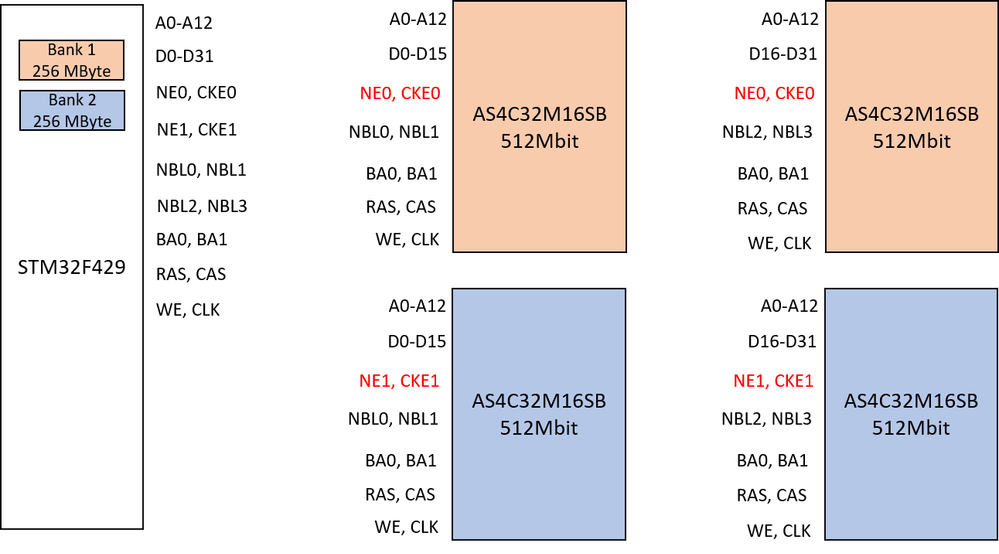

bestamigunay
0693W00000QLrhdQAD.pngFor total 2 Gbit SDRAM, is this configuration OK? Also, if I want to use 4 Gbit SDRAM, what should I do?

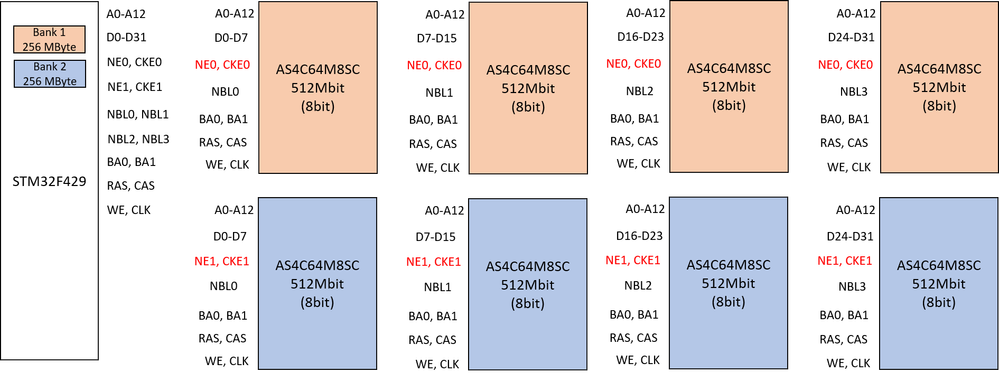

bestamigunay
0693W00000QLuASQA1.pngFor total 4 Gbit SDRAM, is this configuration OK?
