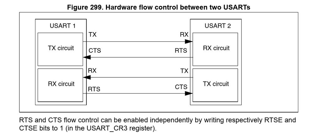

Not quite sure about what you want to achieve, but the first thing to remember is that RTS is not Ready-To-Send. In reality its RTR (Ready-To-Receive) output which is normally connected to the other party CTS input. It becomes active when the receiver is ready for next frame (the double-buffered receive data register is empty).

AScha.3
you understand the control flow ?
0693W00000SwBMBQA3.pngRTS is on receiver side, not sender.
if understanding now ok, whats wrong ?

From your description it appears you are using the USART in a half-duplex, shared bus type architecture. This is very similar to RS485 except you are using tri-state instead of a differential bus. RTS/CTS flow control is designed for RS232 type architectures with a full duplex, two channel point to point wiring. The control lines are tied to managing data flow, to prevent buffer overflows. RTS informs the other side the local node has data ready to send. CTS is asserted by the remote node to indicate the local node can transmit that data without losing data.
In your configuration RTS is NOT a flow control signal. Rather it controls transmit access to the common bus. You will have to manually control the RTS state to manage line turnaround between receive and transmit, according to whatever protocol you are implementing. Do not enable hardware flow control with RTS/CTS.
You might want to research half-duplex RS485 designs, which are very similar to what you are attempting. The STM32F1 series does not have hardware support for line turnaround. You might be better off treating your RTS line as a simple GPIO output pin.
If you haven't used half-duplex shared bus before, be sure to check the USART TC transmit complete status before switching between transmit and receive line state. Remember the USART has an output buffer; using TXE transmit empty does not reflect the buffer status.
