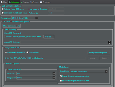

Did you set. enable debug ...low power ?

If you see the code, before entering into the Stop2 mode itself the debugger is getting stuck at 'MX_GPIO_Init()' and showing the error "Target not responding, retrying..."
And yeah, I enabled to debug in low power modes as well.

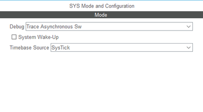

‎2024-07-04 12:52 AM - edited ‎2024-07-04 12:58 AM
So : did you set/enable debug in Cube/ioc ?
If you set the swd/swc pins to another mode (like analog...) it will break the debug connection.
Set debug on the ioc .
