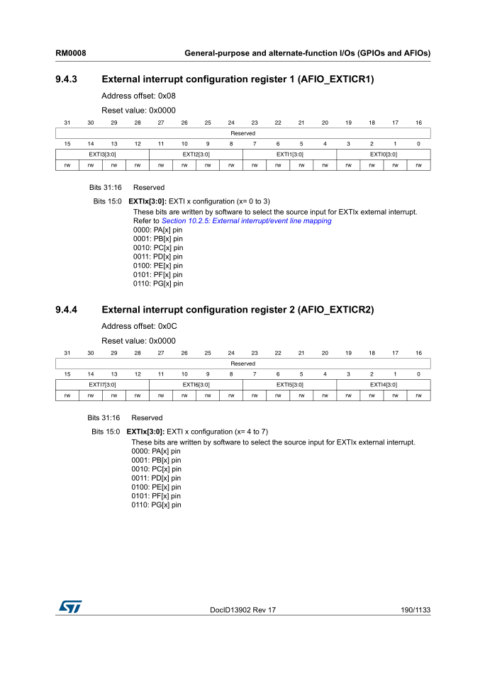

Also, you should've been more explicit in saying which family are you using, in the initial post. In the 'F1, this detail is different from all other families, instead of SYSCFG the EXTI selection is in AFIO.

	/* AFIO_EXTICR[1-4] IRQ Config Registers need to know GPIO Port (A,B,C etc) and Pin.
		No action required here because Reset value just happens to be correct for PA0 on LINE0 */
Heh, indeed, I didn't realize that... :)
