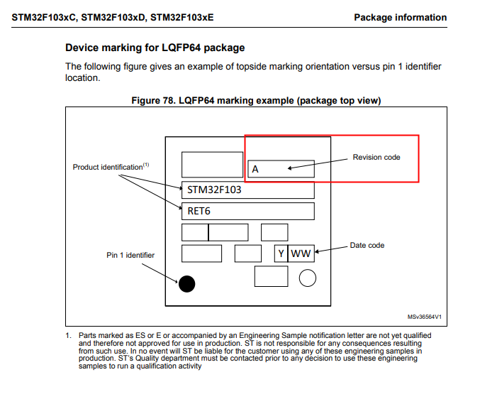

hello:I would like to ask about the specific meaning of the Revision code silkscreen on this chip.During the purchase, I found that the silk screen has 2.3.X etc.I want to know the difference between these chips .

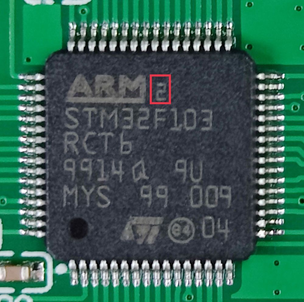

Sorry,Chip is STM32F103.
2021-09-10 03:20 AM
Ok, but still not clear on 2.3.x marking you talk about. Sounds like a code load added to a part by distributor, customer or custom manufacturer.
Most marks are lasered, not silk screened.
Take a photo, large resolution, clear and in focus.
2021-09-10 04:26 AM
OK, thanks. These are the two chips I saw, one X and one 2.

Ok, that should reflect the chip revision / die stepping
It should be readable via an DBGMCU register
The features and issues of give versions should be covered in the Errata documents.

How this impacts your design and software will depend on the peripheral usages, and coincidence with the errors/bugs in each of the respective IC design changes.
Generally ST has been very good at keeping these to a minimum, or hiding the impact in the SPL/HAL library implementations.
You'll need to go through the list, determine what might be impactful, and test/evaluate in your implementation.
This is likely to be a particular issue currently as anyone with old or surplus stock of parts is likely to be selling those via brokers, etc, leading to a random mix, rather than the freshest version of the part straight out of the fab.
