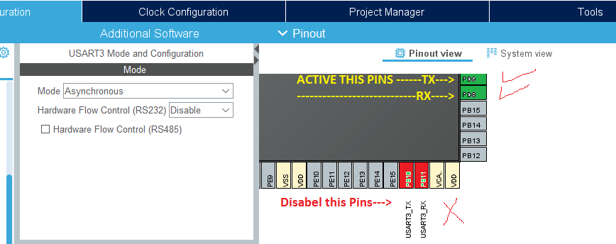

Hello, i am used stm32F767zi, i want to send & receive data by using uart3 from wir STLINKv2.1 between my computer and a card stm32f767zi. but it doesn't work, Anny one can help me please .

Hello Clive,
I try the .HEX it's wrok successfully. thank you.
The problem is resolved.
The problem is cubemxIDE really!, in first when i create uart3 cubemxIDE assigned Pins: PB10 to TX and PB11 to RX. that's why it doesn't work.
The solution is to change Pins TX and RX for uart3 :
Enable pin PD8 and choose USART3_TX
Enable pin PD9 and choose USART3-RX. ( by default now PB10 and PB11 are disable )
Now i can use STLINK-V2.1 by UART3.

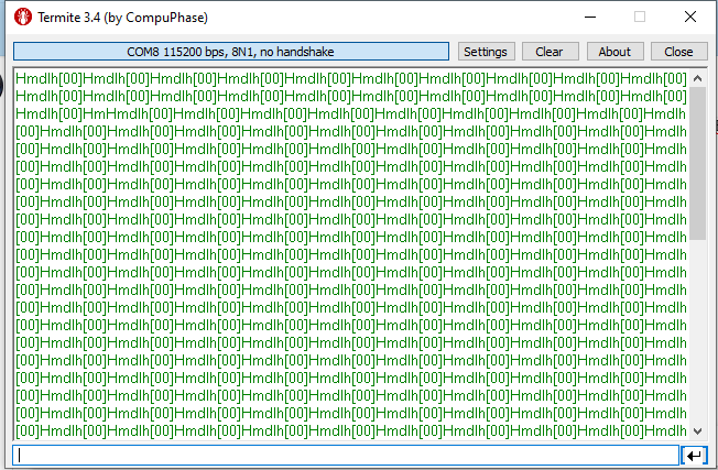

 you can found in the attachment the configuration of UART3 in CubeMxIDE. and console of output message in console sending by UART3.
O, really? Does it has to have an integrated crystal ball to know which pins your project will need? And, by the way, for ST's boards CubeMX has a board selector, which has the respective pins pre-pinned.
