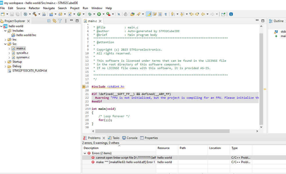

hello can any one help me ? Description Resource Path Location Type cannot open linker script file D:\??????????\Self Learning\???????????? ??????????\nti arm microcontroller\my workspace\hello world\STM32F103C6TX_FLASH.
asher.1
6 REPLIES 6
Does the path to the linker have non-ascii characters in it?
Doesn't look like a usable path.
Avoid Hieroglyphs and Pictograms, and use simple paths with Western characters.
how can i change the path of the linker ,please?
You edit it in the project settings -> Tool settings -> Linker
there is no project settings in my ide ,i run ide version 1.12.1!!!
