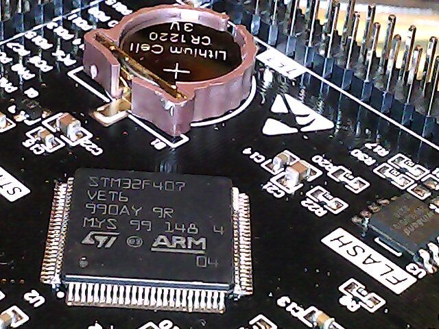

I've got a few of the Aliexpress Chinese STM32F407VET6 development boards that arrived recently. I became suspicious when the content of 0x1FFF7A22 is reported as 0xffff, when it should be the flash size in KB. The MCU chip itself reads:
STM32f407
VET6
991ES 9R
MYS 99 145 4
ST e3 ARM
04
Note that there's no revision number, which immediately made me suspicious. The MCU at first blush, seems to work okay, but what should I be aware of if I should try to use it?

A picture would help, high resolution, in focus
The ES is suggestive that it is an Engineering Sample, which would explain the OTP not being programmed.
It is not out of the French Fab
The "4" is a valid marking, and consistent with the mask set / fab

Here's a photo. I also have some with the 06 marking. What perplexes me is the 0xffff read from the flash size register. It also seems to confuse OpenOCD, which defaults to 1024K flash size. A known-valid STM32407VET6 reads 0x200 in the same location.0693W00000WJhoAQAT.jpg

This has different markings than you mentioned earlier.
Does this have the boot loader and Flash size as 0xFF ?
The OpenOCD app should identify the Core, and that's usually different for CKS vs ST

On the one I initially reported:
openocd reports Info : device id = 0x10076413
memory at 0x1FFFF000: 0xffffffff
flash size = 0xffff
On the one in the photo, same device ID, but flash size register is 0x200.
I'll attach a photo of the one I initially reported a bit later...
I should note that both came from the same shipment.

The type font looks more like what one sees on the Gigadevice GD32F407VET6--sort of an OCR-A.
What with the chip shortage, I wonder how many "clone" manufacturers are taking advantage of the situation...

That's my problem--if the chips were "GD32F4" or "CKS32F4" labeled, at least I'd know what I was getting.
So, to answer my own question "Are there STM32F407 fakes out there?" The answer is clearly "Yes!"
chuck guzis
November 29, 2022
Here's a photo of the MCU that shows 0xffff for the flash size. While it seems to work, I'm going to swap it out for one that reports flash correctly. I don't need another thing to worry about. What's notable on this one is how "ARM" is quite visible from a distance, but the rest of the chip labeling is a bit faded.
