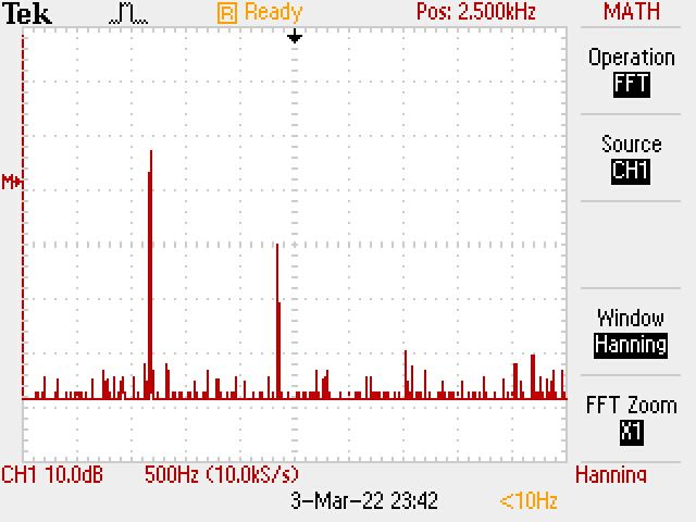

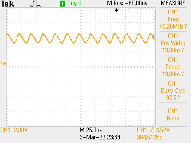

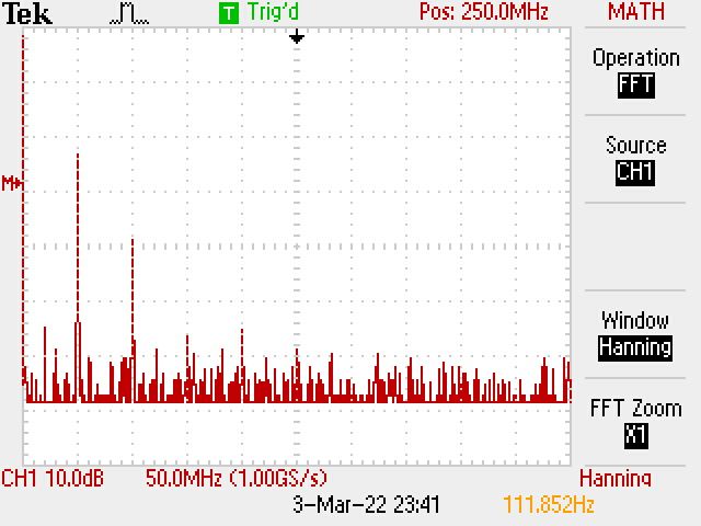

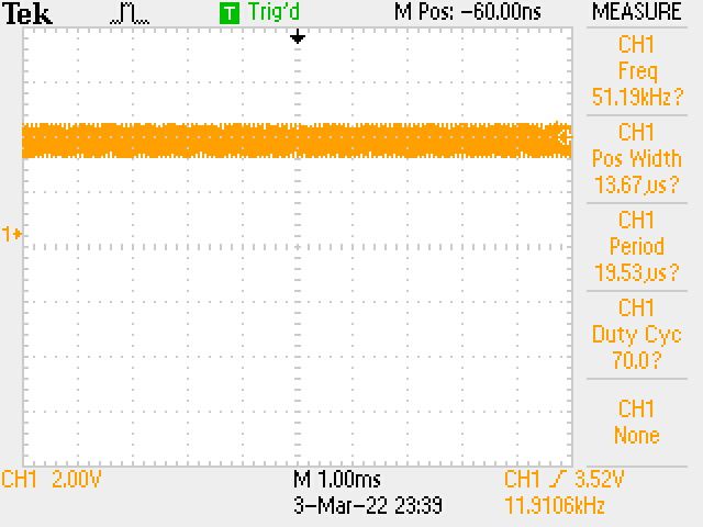

Harmonics are present on Idle State TIM1 Channel 1 One pulse Mode How to remove them ?
DPatr.2
Using STM32F429ZIT6 - Nucleo
Here's what I observe on PE9. Counter Mode is upcounting, PWM Mode 2
0693W00000KbJYuQAN.jpg0693W00000KbJYVQA3.jpg0693W00000KbJXrQAN.jpg0693W00000KbJXNQA3.jpg

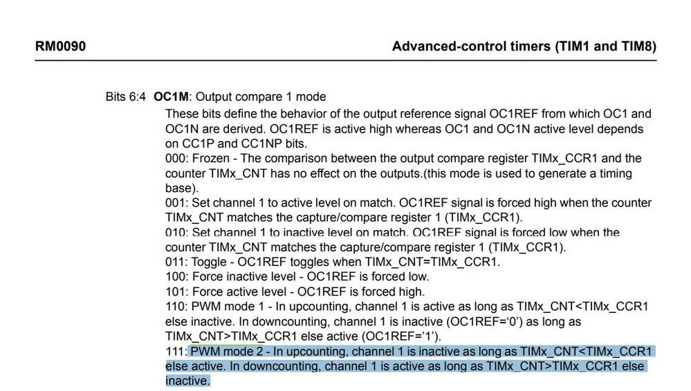

At first, I thought there had conflicts in the parameters (OCMode, OCPolarity and OCIdleState) of MX_TIM1_Init() function
static void MX_TIM1_Init(void)

  sConfigOC.OCMode = TIM_OCMODE_PWM2;
  sConfigOC.Pulse = 1;
  sConfigOC.OCPolarity = TIM_OCPOLARITY_LOW;
  sConfigOC.OCNPolarity = TIM_OCNPOLARITY_LOW;
  sConfigOC.OCFastMode = TIM_OCFAST_DISABLE;
  sConfigOC.OCIdleState = TIM_OCIDLESTATE_SET;
  sConfigOC.OCNIdleState = TIM_OCIDLESTATE_SET;

But after checking documentation, I think thoses are fine!?
Not sure what is causing the issue, any Ideas ?

Digital signals have (theoretically) infinite steep edges, so harmonics are always present. That's something analog, not digital. If you care about RF emission, you may select the pin speed (driver strength) according to the frequencies you're expecting.
hth
KnarfB
waclawek.jan
Which STM32? What hardware?
This looks more like interference/improper ground etc.
Set the pin as Output in GPIO_MODER and try different OSPEEDR settings.
Also try on a "known good" board such as Nucleo or Disco (after having disconnected all potential on-board circuitry connected to given pin).
This was observed on STM32F429ZIT6 - Nucleo board which should be a "known good" board.

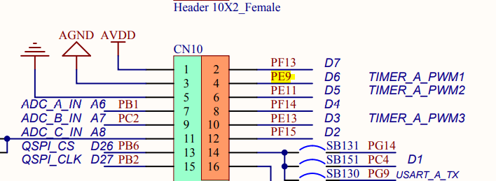

My oscilloscope has sampling probe on a wire going in D6 (PE9) and reference probe on GND Pin 5 of CN10. I dont think its improper ground.
Do you mean electromagnetic interference ? I dont see any source around me that could generate this frequency.

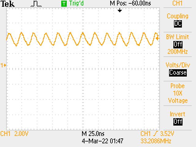

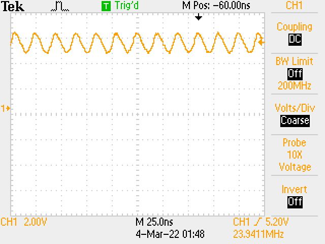

I poked 3V3 line on CN8 Pin 7 and 5V line CN8 Pin 9 and here's what I observed ;
3V3 CN8 Pin 7
Maybe I damaged the on board regulator or filtering capacitor on power lines with an ESD ?

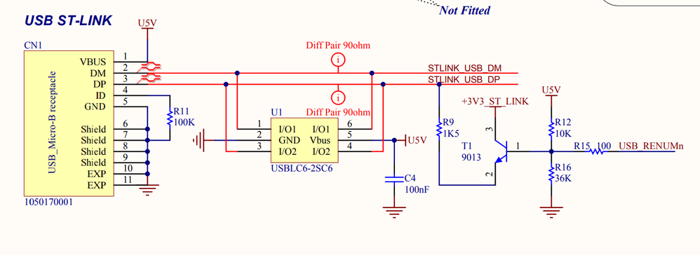

DPatr.2
I poked U5V on R12 that is the 5V source coming from my USB port
and I observed the same ripples. It looks like that is root cause and the solution would be to have a cleaner (less ripples) power source.
