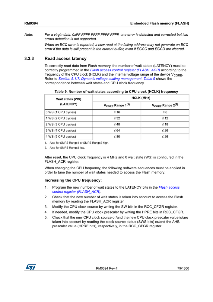

Make sure the flash wait states are appropriate for the speed you are clocking the MCU

Tesla - what exactly do you mean by "flash wait states" ?
0693W00000DmCY8QAN.pngJW
