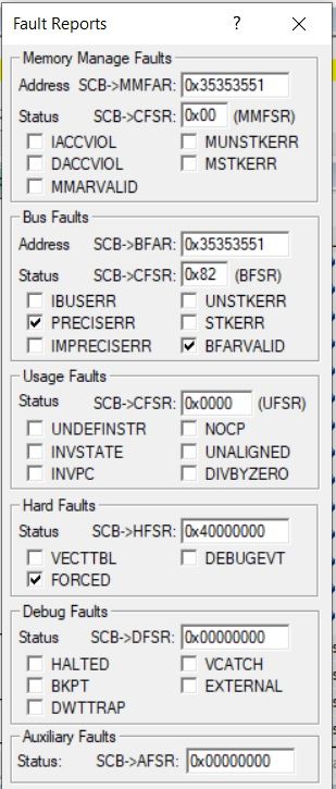

Hi All,
I config UART on interrupt, after receving data on UART simple sending data at that time hard fault occur.
UART enabling code
 MX_GPIO_Init();
  MX_DMA_Init();
  MX_USART2_UART_Init();
  MX_RTC_Init();
  MX_SPI3_Init();
  MX_TIM2_Init();
  MX_TIM15_Init();
  MX_TIM1_Init();
  MX_TIM4_Init();
  MX_TIM8_Init();
  /* USER CODE BEGIN 2 */
	__HAL_UART_ENABLE_IT(&huart2,UART_IT_RXNE);
UART handler
void USART2_IRQHandler(void)
  /* USER CODE BEGIN USART2_IRQn 0 */
  /* USER CODE END USART2_IRQn 0 */
  HAL_UART_IRQHandler(&huart2);
  /* USER CODE BEGIN USART2_IRQn 1 */
	HAL_UART_Receive_IT(&huart2,rx_data,14);
  /* USER CODE END USART2_IRQn 1 */
Hal is not proving variable length string on interupt So I make them fix length of string.
Once I get the data after that sending data via
HAL_UART_Transmit(&huart2, response,11,200);
After that... If any once has any suggetion let me know or also tell me how to debug hard fault or any exceptions.

Check what HAL_UART_Receive_IT() actually does. Don't guess.
ASaxe
@turboscrew​ Receive an amount of data in interrupt mode. is there anything specific you want to tell tell me because I didn't get your point
turboscrew
Senior III
It doesn't quit do what you expected?
HAL_StatusTypeDef HAL_UART_Receive_IT(UART_HandleTypeDef *huart, uint8_t *pData, uint16_t Size)
 /* Check that a Rx process is not already ongoing */
 if (huart->RxState == HAL_UART_STATE_READY)
   if ((pData == NULL) || (Size == 0U))
     return HAL_ERROR;
   /* Process Locked */
   __HAL_LOCK(huart);
   huart->pRxBuffPtr = pData;
   huart->RxXferSize = Size;
   huart->RxXferCount = Size;
   huart->ErrorCode = HAL_UART_ERROR_NONE;
   huart->RxState = HAL_UART_STATE_BUSY_RX;
   /* Process Unlocked */
   __HAL_UNLOCK(huart);
   /* Enable the UART Parity Error Interrupt */
   __HAL_UART_ENABLE_IT(huart, UART_IT_PE);
   /* Enable the UART Error Interrupt: (Frame error, noise error, overrun error) */
   __HAL_UART_ENABLE_IT(huart, UART_IT_ERR);
   /* Enable the UART Data Register not empty Interrupt */
   __HAL_UART_ENABLE_IT(huart, UART_IT_RXNE);
   return HAL_OK;
 else
   return HAL_BUSY;
Thanks for you support.
I found the issue.... this because my logic is not working as I expected. or I can say issue in my logic which is leads to a hard fault.
