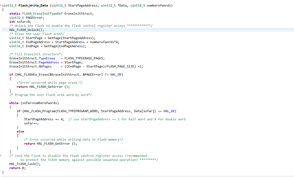

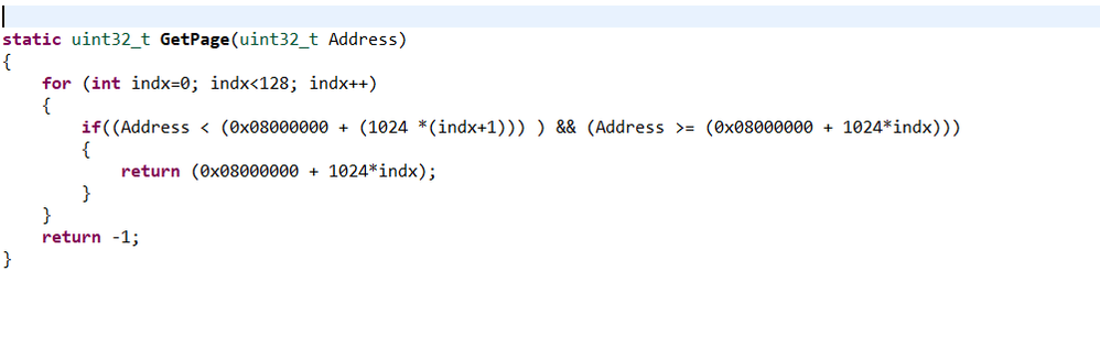

Recently I started working on stm32 microcontroller. I am trying to write/read data from Flash memory of stm32f070cb.
I have tried writing as well as reading data from internal flash memory using stm32f072 disco evaluation board and it is working fine.
Now I am trying to integrate the same code on the custom board having stm32f070cb MCU, but while erasing memory from flash initially before writing the data, I am facing hardfault error.
I have attached the code snippet. Please support to fix this issue.

Please post as code blocks ( </> ) rather than images, I can't use images on several devices.
Have a proper Hard Fault handler to quickly identify what exactly the processor has an issue with. I've post many examples.
Check alignment, check you are going out-of-bounds.
Add instrumentation so you understand what's happening.
Sanity check addresses.
Check you're not erasing memory your code is executing from.
> EraseInitStruct.PageAddress = StartPage;
You're providing a page number to something that asks for a page address.
