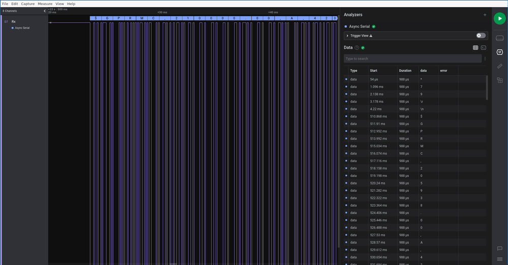

The GPS module has direct USB connection and I can see that 9600 baud with no parity and 1 stop bit is the correct configuration. My logic analyzer confirms this as well.
Does anyone know what might be causing this to occur?

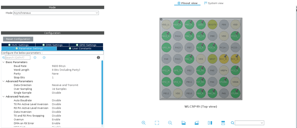

CubeMX Setup for USUART1 (GPS UART)

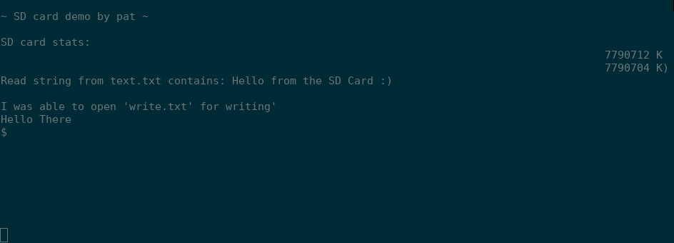

0693W00000HrSeIQAV.pngSerial Terminal Capture (Occasionally when it first polls in the middle of the window it will publish a garbage character, but as you can see it only reads the first char, then prints only the new lines from the transmit, the buffer remains empty)

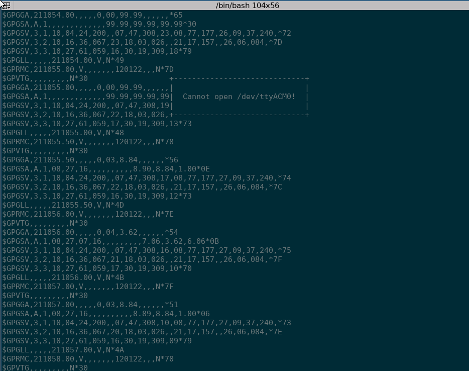

Serial Terminal Output when GPS connected directly to PC
Logic Analyzer Settings
0693W00000HrSeDQAV.pngLogic Analyzer Capture (This is what the HAL should receive, or at least some snippet of it)

Check the overrun flag. You are probably receiving multiple characters without reading them out. In this case, the first character will stay, the overrun flag will be set, and any characters after that are discarded.
Setting up UART reception in circular DMA mode will be the most robust. Otherwise, you need to ensure the transmitter doesn't send data until you're ready for it, which is usually difficult if not impossible.
Going to timeout if you take more than a second to type.
The interleaved nature of the polling doesn't really lend itself to concurrent reception and transmission, and the receive buffer on the UART is only one byte deep, you have to be responding and buffering as each by comes in. If you get distracted, or are waiting multiple byte times for other data to be sent out, you will miss the service window on the receive side.
waclawek.jan
For UART at 9600 baud, I would recommend interrupts rather than DMA, except for very well justified cases. Not the Cube/HAL variety, of course, but implementing proper ring buffers.
