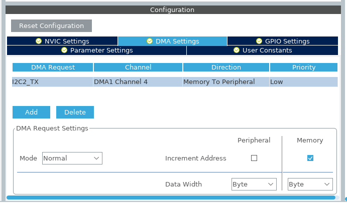

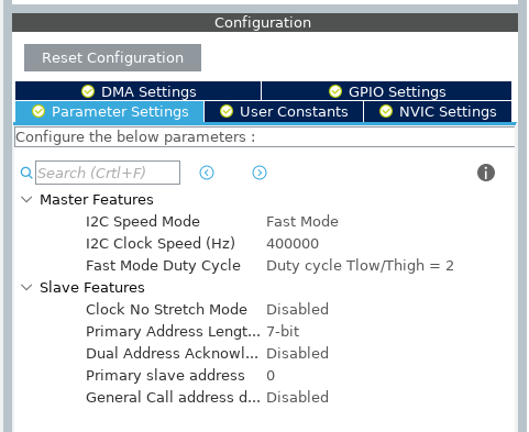

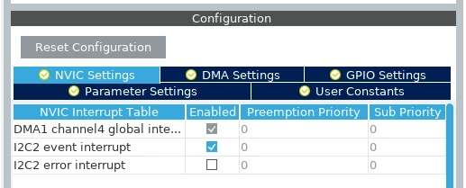

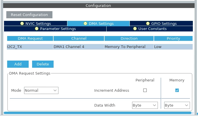

The blocking version (HAL_I2C_Mem_Write) works nicely, now I'm trying to use HAL_I2C_Mem_Write_DMA. Here are the settings as given in the configuration tool.
The resulting code generated by the configurator (I removed some comments for brevity):
static void MX_DMA_Init(void)
 __HAL_RCC_DMA1_CLK_ENABLE();
 HAL_NVIC_SetPriority(DMA1_Channel4_IRQn, 0, 0);
 HAL_NVIC_EnableIRQ(DMA1_Channel4_IRQn);

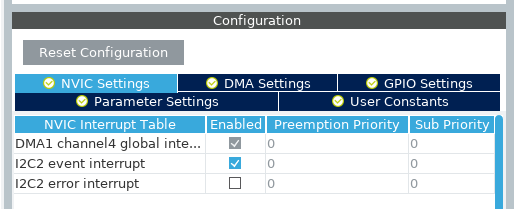

 /* I2C2 interrupt Init */
 HAL_NVIC_SetPriority(I2C2_EV_IRQn, 0, 0);
 HAL_NVIC_EnableIRQ(I2C2_EV_IRQn);

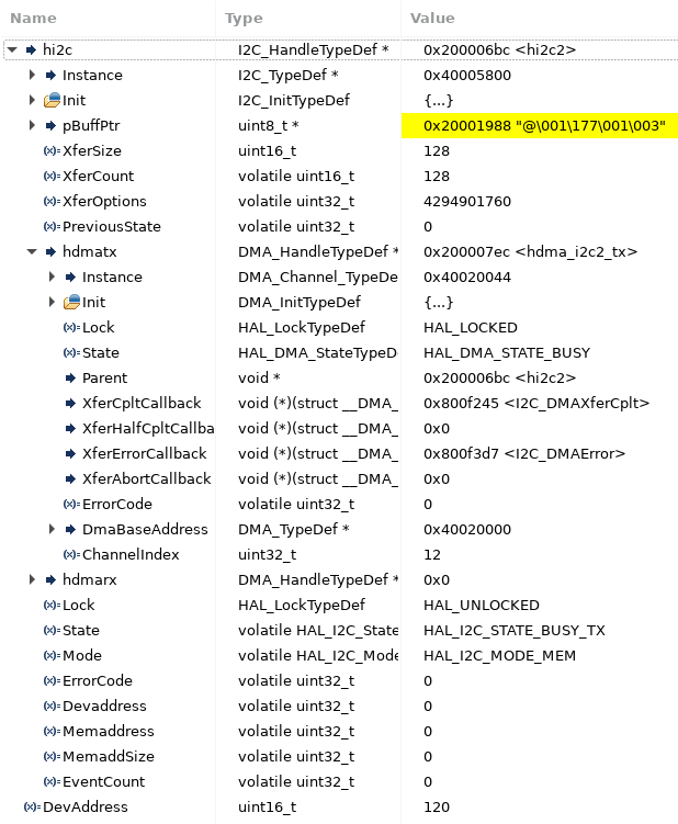

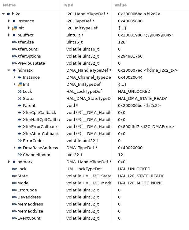

HAL_I2C_Mem_Write_DMA returns HAL_OK. When I step inside it, this is the state immediately before it returns:
Note that XferCount starts as 128.

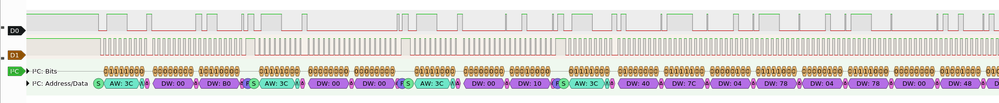

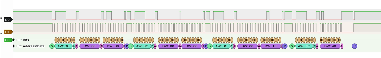

Here is the view from my logic analyzer, first the result from the blocking (non-DMA) call:

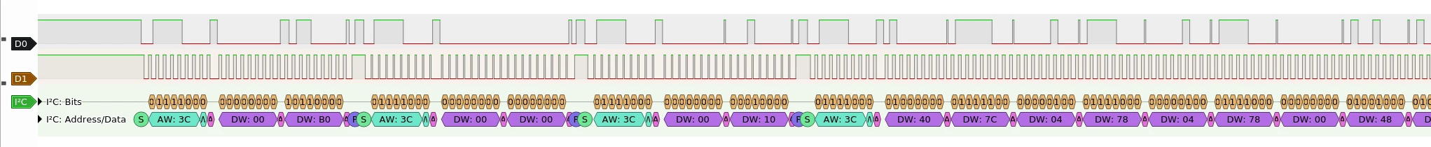

Now the result from the DMA version:
Only the MemAddress (0x40) is sent. The data buffer seems to be completely ignored.

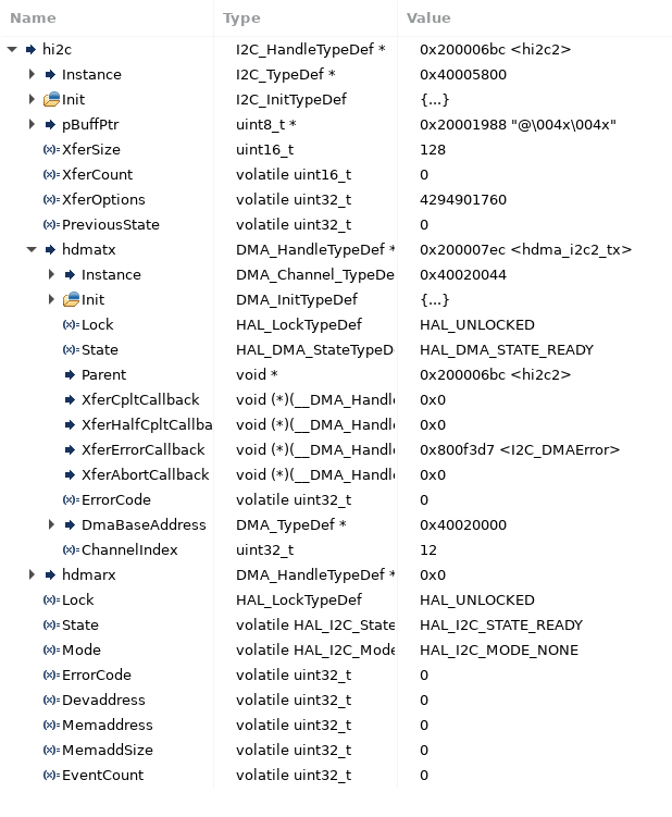

When I place a breakpoint in the callback, XferCount has become zero, and the State and Mode are 'ready' and 'none' respectively. As far as I know this is what should be expected from normal operation.

Best answer by iforce2d
Okay, I finally figured this out. The configuration tool was generating calls like this:
 MX_I2C2_Init();
 MX_DMA_Init();
.... but these need to be in the opposite order, with the DMA one first. So all I had to do is reverse them.
I think the problem is that I first configured I2C without any DMA, and then later came back to enable the DMA setting. As you enable more features, the tool simply appends any newly required calls to the end of the generated list.
Unfortunately the configuration tool also continued to persistently re-arrange these calls in the wrong order every time I generated code after this. The solution seems to be like this:
  1. completely disable the I2C peripheral (and I suppose others using DMA too...)
  2. generate code (both calls will be removed from the generated code)
  3. enable the I2C again with DMA request, interrupt etc
  4. generate code again
When the I2C and DMA are enabled and generated together, the two calls will be in the correct order and will remain so in future code generations.
So I lost 6 hours here, but still probably less time than if I didn't have the configuration tool. Would be nice to see this problem fixed sometime though.
