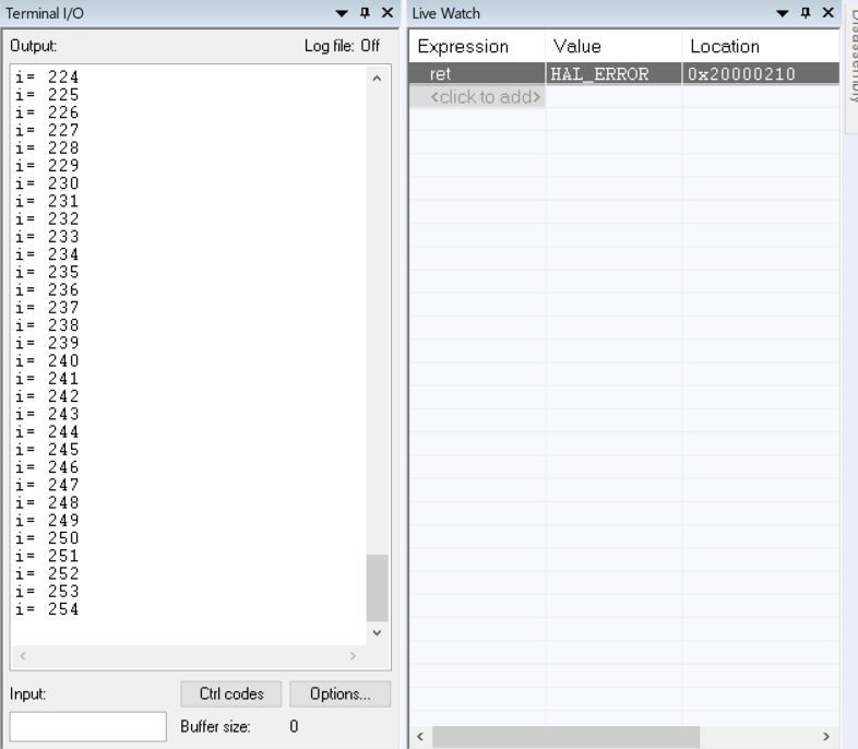

HAL_I2C_IsDeviceReady = HAL_ERROR
Malek Mahar
i'm trying to connect an STM32L072cz mcu ( as a master ) to a gas-module (as a slave) which 7-bit address from data sheet is "1100101b",
Wiring, pull-up resistors are placed correctly,
i'm trying to test if the communication is well established between the MCU and the sensor, but all I have is a HAL_ERROR from HAL_I2C_IsDeviceReady(),
NB : THIS CODE IS AUTOMATICALLY GENERATED FROM CubeMX
this is my code :

 for(i=0; i<255; i++)
   ret = HAL_I2C_IsDeviceReady(&hi2c1, i, 10, 100);
   printf("i= %d\n", i);
   if(ret == HAL_OK)
    printf("OK");
    break;

and this is the result after debugging,
HAL_ERROR indicates there is no slave device that responds to that address. More information is in the ErrorCode parameter.
https://github.com/STMicroelectronics/STM32CubeL0/blob/a7b74aed35ecb7baeadeb16107aa8fddb6823589/Drivers/STM32L0xx_HAL_Driver/Src/stm32l0xx_hal_i2c.c#L3147
Note that slave address are 7 bits (not 8) and should be left-aligned.
Recheck wiring and external pullup resistors. Put a scope on SDA/SCL to verify signal is sent correctly.
2 REPLIES 2
