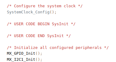

why is sys-clk-config light grey ?

no idea actually, seems normal to me in the editor. I changed theme to black now to see the difference but they all look the same either way
I created a new project and pasted your code in and it's the same. doesnt work :\
this CANNOT be wrong...
