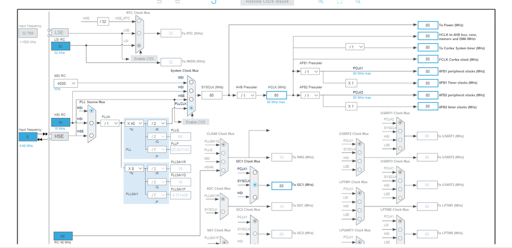

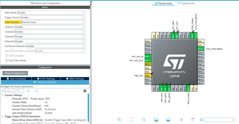

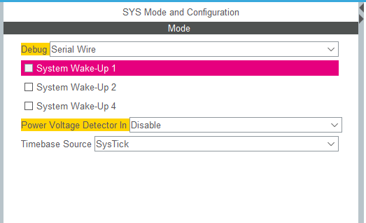

So I've created a project and am trying to use the HAL_delay(10); but it gets stuck at this function when im trying to debug.
I have been changing the clock and enabling the TIM2 so I don't know if i've messed something up. Here are the settings that I have:

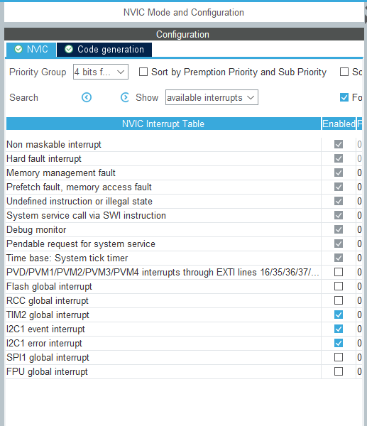

where you call hal-delay? in INT ? you give all ints same (highest) priority 0 , so Systick cannot be called from same level. -> set tim2 2 , i2c..3 or so.
PPopo.1
Senior
I call it in main function. I will try setting priority and will get back to you
PPopo.1
Senior
_legacyfs_online_stmicro_images_0693W00000biApFQAU.pngI changed it like so and it still gets stuck at HAL_delay(10);

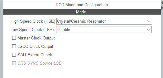

just..why not use the hse ?? (and pllm /2)
_legacyfs_online_stmicro_images_0693W00000biArQQAU.png+
is program running when just run/start in debug? (and stop with suspend/pause )
PPopo.1
Senior
I tried it with hsi, still not working. Yes, it seems like its running fine but cant really check because the live expression values are not showing for some reason. Also, do I need to do anything in the code to enable delay? I havent done anything, just tried to use it with hal_delay()

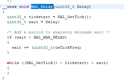

HAL_Delay(310); -- should just work. (but not: HAL_delay(10); ! d -> D !
if you have correct function call, just go in editor on the word with mouse cursor, you see in popup window the definition. if nothing shows up - wrong.
see on compile also every warning !!! only zero is good ->
<<15:23:20 Build Finished. 0 errors, 0 warnings. (took 3s.872ms) >>
PPopo.1
Senior
_legacyfs_online_stmicro_images_0693W00000biAsxQAE.pngThere is a declaration but it has been autogenerated, i didnt do it. I also have 9 warrning but only for unused variables later in the code. I tried 310 and also hal_delay(350), nothing works
