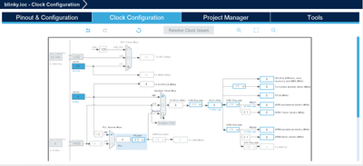

i'm trying to run a simple blinking led program on my stm32f103c8t6 (after i run it several times before successfully), and it doesn't work, when i fix the delay in 1000 ms the led is always on, when i decrement it to 100, 200, 300 it's working properly, but whenever i go above 400 ms it's not working:

HAL_Delay() depends on HAL_GetTick()... So not sure how the hardware is causing the issue if it works up to 400ms, so I am curious
You code works well on my board.

Hi Andrew Neil,
The program in question is HAL_Delay() which is just waiting in a loop to check if the HAL_GetTick() increments till the delay. So if it works for 400ms why does it not work for higher values? Is it  a software bug or can it be caused by HW bug?
still getting exactly the same problem as before !
