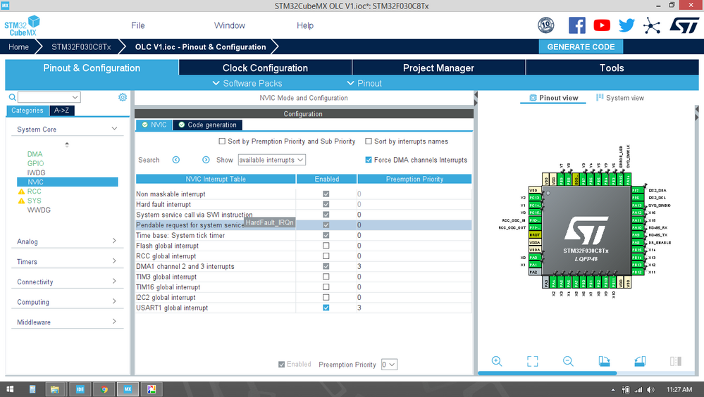

when i call HAL_Delay(10); function code goes infinite loop why?

2 REPLIES 2
Guillaume K
HAL_Delay() calls HAL_GetTick() which relies on global variable uwTick which is updated by Systick IRQ handler SysTick_Handler().
is the systick frequency correctly configured ?
Do you have an interrupt that has higher priority than systick interrupt and happens continuously ? ( lower value means higher priority on Cortex M processors)
Systick interrupt having higher priority as shown in image
uwTick is increment also​ systick interrupt also call but still goes in infinite loop
In another my question ​I shared my all projects files where same issue
