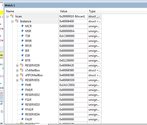

I was just started with CAN peripheral on my stm32f446re nucleo board.
The problem i am facing is HAL_CAN_Init()  added by cubeMx code generation software is failing at the below line of code
it is returning HAL_ERROR in CAN1 LOOP BACK MODE
That means the controller has not set SLAK to zero even if we clear the SLEEP bit
i believe that CAN TX is internally connected to can rx and can rx is not sampled .
on the board i have made no connection to the can tx and can rx. its just a single board.
Please let me know what i am doing wrong .

here is picture of all reg contents

Posted on May 09, 2018 at 12:59
You must be running without a transceiver chip.
so therefore you need a pullup on the CAN Rx pin.       <- your fix

Hello T J , ,
Thanks for replying . yes after pulling up rx line with 3.3k resistor the above problem got resolved. ,
But still i am not able to rcv the same packet sent in loop back mode. ,
The RX is not getting any packets . ,

I am having the same issue. As i understand it -- pull-up resistor is when you connect CAN Rx to 3.3V or 5V on your STM board through a resistor. I wonder why did you use exactly 3.3k resistor and not 5k Ohm or something. And I would like to know to what voltage should the Rx pin been pulled-up -- 3.3V or 5V exactly, my STM board has both of them.
Thank you for your answers.
RN
Senior
if you are not using transceiver chip and wan to test CAN loopback mode, pullup can_rx to 3.3v via resistor. otherwise can_init() will fail .
AMerz
Thank you. Do I have to use 3.3kOhm resistor, or some other value may suffice?
T J
Lead
any value except <2V on the pin ...
100K would probably work, just...
AMerz
Thank you, I think I'll use 10k as I have it handy.
