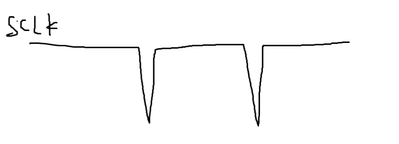

this is my reading code.Because of the lacking of detectiving device,I opend an ADC channel to try to detect the SPI signal.I compared the SCLK's wave of C8T6 and H723,I found that when the command coming ,SCLK genertated a chaging (
)but H723 still kept a line without changes.
Do you not have a scope with a screenshot facility?
no.maybe tommorrow i can get one scope to use

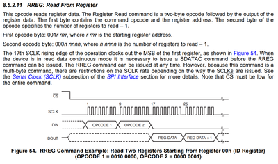

This is the code I read and write register
//读写多个寄存器
void ADS1292_WR_REGS(u8 reg,u8 len,u8 *data)
		u8 i;
		ADS_CS=0;
		delay_us(1000);
		ADS1292_SPI(reg);
		delay_us(1000);
		ADS1292_SPI(len-1);
		if(reg&0x40) //写
				for(i=0;i<len;i++)
						delay_us(1000);
						ADS1292_SPI(*data);
						data++;
		else //读
				for(i=0;i<len;i++)
						delay_us(1000);
						*data = ADS1292_SPI(0);
						data++;
		delay_us(100);
		ADS_CS=1;
//寄存器数组写入寄存器
u8 ADS1292_WRITE_REGBUFF(void)
		u8 i,res=0;
		u8 REG_Cache[12];	//存储寄存器数据
		ADS1292_SET_REGBUFF();//设置寄存器数组
		ADS1292_WR_REGS(WREG|CONFIG1,11,ADS1292_REG+1);//数组变量写入寄存器
		delay_ms(10);
		ADS1292_WR_REGS(RREG|ID,12,REG_Cache);//读寄存器
		delay_ms(10);
		for(i=0;i<12;i++	)	//检查寄存器
				printf("Write: 0x%02X, Read: 0x%02X\r\n", ADS1292_REG[i], REG_Cache[i]);
				if(ADS1292_REG[i] != REG_Cache[i])
						if(i!= 0 && i!=8 && i != 11)	//0 8 和11是ID 导联脱落和GPIO相关
								res=1;
						else
								continue;
		return res;
you can see that there 3+ bytes are  transferred when I write or read registers.The problem exists in the ADS1292_SPI(0),
u8 ADS1292_SPI(u8 com)
		return SPI2_ReadWriteByte(com);
uint8_t SPI2_ReadWriteByte(uint8_t TxData)
	uint8_t Rxdata;
  HAL_SPI_TransmitReceive(&hspi4,&TxData,&Rxdata,1, 1000);
 	return Rxdata;          		    //返回收到的数据
the data I recieved is always 0,which means I didn't receive the data which is read form register
