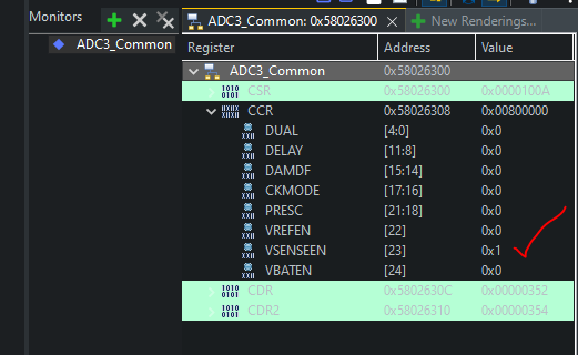

Yes, it was disabled. Now I enable it, by this line:
LL_ADC_SetCommonPathInternalCh(__LL_ADC_COMMON_INSTANCE(ADC3), LL_ADC_PATH_INTERNAL_TEMPSENSOR);
But I am not sure, that measure adc3 is fine. I'll try to do some measurements.:thumbs_up:

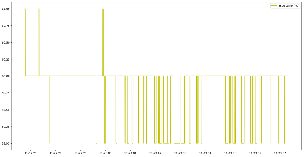

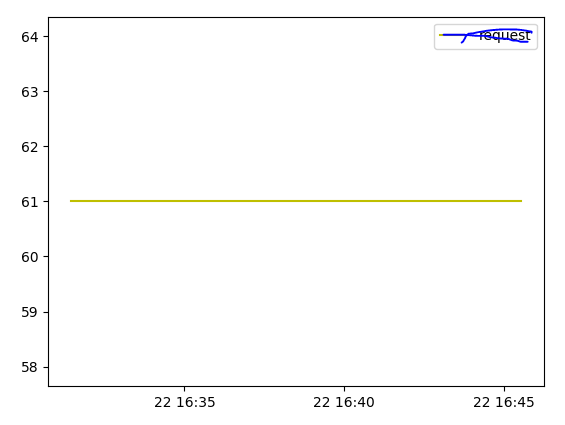

I started measuring. I measured for about 15 minutes. It looks good. Tomorrow I will continue.
@Gwenole BROCHARD​  Thank you for your advice.
I measured the temperature on the MCU for about 8 hours. It fluctuated within 2 ° C. I think that's good. With the help of @Gwenole BROCHARD​  there are source codes.

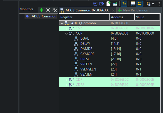

Pilous Droip
Senior
So today I added another channel. And I think adc is working badly in my setup.
Here is complete code:
Clock source
PeriphClkInitStruct.PeriphClockSelection = RCC_PERIPHCLK_ADC;
    PeriphClkInitStruct.PLL3.PLL3M = 4;
    PeriphClkInitStruct.PLL3.PLL3N = 100;
    PeriphClkInitStruct.PLL3.PLL3P = 2;
    PeriphClkInitStruct.PLL3.PLL3Q = 2;
    PeriphClkInitStruct.PLL3.PLL3R = 4;
    PeriphClkInitStruct.PLL3.PLL3RGE = RCC_PLL3VCIRANGE_1;
    PeriphClkInitStruct.PLL3.PLL3VCOSEL = RCC_PLL3VCOWIDE;
    PeriphClkInitStruct.PLL3.PLL3FRACN = 0;
    PeriphClkInitStruct.AdcClockSelection = RCC_ADCCLKSOURCE_PLL3; // R output = ((8MHz / 4) * 100) / 4 = 50MHz

I used a freezer before starting the MCU. Now I have a problem with the PF10 value. This value is not measured.
The time in ms is given in parentheses.
[02011] TEMP=24; PF10=580;  VREF=1269
[03016] TEMP=27; PF10=598;  VREF=1268
[04021] TEMP=28; PF10=591;  VREF=1268
[05026] TEMP=27; PF10=578;  VREF=1269
[06031] TEMP=29; PF10=593;  VREF=1269
[07036] TEMP=31; PF10=571;  VREF=1269
[08041] TEMP=34; PF10=587;  VREF=1269
[09046] TEMP=37; PF10=571;  VREF=1270
[10051] TEMP=40; PF10=570;  VREF=1269
[11056] TEMP=42; PF10=606;  VREF=1271
[12061] TEMP=44; PF10=609;  VREF=1270
[13066] TEMP=45; PF10=605;  VREF=1271
[14071] TEMP=46; PF10=605;  VREF=1270
[15076] TEMP=48; PF10=623;  VREF=1270
[16081] TEMP=48; PF10=617;  VREF=1270
[17086] TEMP=49; PF10=626;  VREF=1269
[18091] TEMP=49; PF10=635;  VREF=1271
[19096] TEMP=49; PF10=634;  VREF=1271
[20101] TEMP=51; PF10=612;  VREF=1270
[21106] TEMP=51; PF10=611;  VREF=1270
[22111] TEMP=51; PF10=604;  VREF=1270
[23116] TEMP=52; PF10=612;  VREF=1270
[24121] TEMP=52; PF10=614;  VREF=1270
[25126] TEMP=52; PF10=620;  VREF=1271

        LL_ADC_EnableInternalRegulator(ADC3);
        __IO uint32_t wait_loop_index = 0UL;
        wait_loop_index = ((LL_ADC_DELAY_INTERNAL_REGUL_STAB_US / 10UL) * (SystemCoreClock / (100000UL * 2UL))) + 1000;
        while (wait_loop_index != 0UL) {
            wait_loop_index--;
    LL_ADC_SetCommonPathInternalCh(__LL_ADC_COMMON_INSTANCE(ADC3), LL_ADC_PATH_INTERNAL_TEMPSENSOR | LL_ADC_PATH_INTERNAL_VREFINT | LL_ADC_PATH_INTERNAL_VBAT);
    LL_ADC_SetCommonClock(__LL_ADC_COMMON_INSTANCE(ADC3), LL_ADC_CLOCK_ASYNC_DIV1);
    LL_ADC_SetResolution(ADC3, LL_ADC_RESOLUTION_16B);
    LL_ADC_REG_SetSequencerLength(ADC3, LL_ADC_REG_SEQ_SCAN_ENABLE_3RANKS);
    LL_ADC_SetLowPowerMode(ADC3, LL_ADC_LP_MODE_NONE);
    LL_ADC_REG_SetContinuousMode(ADC3, LL_ADC_REG_CONV_CONTINUOUS);
    LL_ADC_REG_SetSequencerDiscont(ADC3, LL_ADC_REG_SEQ_DISCONT_DISABLE);
    LL_ADC_REG_SetTriggerSource(ADC3, LL_ADC_REG_TRIG_SOFTWARE);
    LL_ADC_REG_SetDataTransferMode(ADC3, LL_ADC_REG_DMA_TRANSFER_UNLIMITED);
    LL_ADC_REG_SetOverrun(ADC3, LL_ADC_REG_OVR_DATA_OVERWRITTEN);
    LL_ADC_SetOverSamplingScope(ADC3, LL_ADC_OVS_DISABLE);
    LL_ADC_SetBoostMode(ADC3, LL_ADC_BOOST_MODE_50MHZ);
    LL_ADC_SetMultimode(__LL_ADC_COMMON_INSTANCE(ADC3), LL_ADC_MULTI_INDEPENDENT);
    LL_ADC_REG_SetSequencerRanks(ADC3, LL_ADC_REG_RANK_1, LL_ADC_CHANNEL_TEMPSENSOR);
    LL_ADC_SetChannelSamplingTime(ADC3, LL_ADC_CHANNEL_TEMPSENSOR, LL_ADC_SAMPLINGTIME_387CYCLES_5);
    LL_ADC_SetChannelSingleDiff(ADC3, LL_ADC_CHANNEL_TEMPSENSOR, LL_ADC_SINGLE_ENDED);
    LL_ADC_REG_SetSequencerRanks(ADC3, LL_ADC_REG_RANK_2, LL_ADC_CHANNEL_6);
    LL_ADC_SetChannelSamplingTime(ADC3, LL_ADC_CHANNEL_6, LL_ADC_SAMPLINGTIME_8CYCLES_5);
    LL_ADC_SetChannelSingleDiff(ADC3, LL_ADC_CHANNEL_6, LL_ADC_SINGLE_ENDED);
    LL_ADC_REG_SetSequencerRanks(ADC3, LL_ADC_REG_RANK_3, LL_ADC_CHANNEL_VREFINT);
    LL_ADC_SetChannelSamplingTime(ADC3, LL_ADC_CHANNEL_VREFINT, LL_ADC_SAMPLINGTIME_64CYCLES_5);
    LL_ADC_SetChannelSingleDiff(ADC3, LL_ADC_CHANNEL_VREFINT, LL_ADC_SINGLE_ENDED);
    LL_ADC_EnableIT_EOS(ADC3); // End of regular sequence of conversions IR enable
