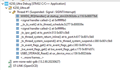

so you want access SD-card , and then USB as MSC device ? (Its like a sd-card reader on USB ? )
VT_Jim
@AScha.3  I need to have this look like a microSD card reader to the user, but it is a memory controller device for a musical instrument.  Files get put into the SD via the USB.
I have tested the SD (SDMMC1) is working fine.  It reads my cards.  I have also gotten the USB to show up on my PC as MSC device but with failure.  The event logs for Windows show that the USB has the correct Vendor ID, etc.
But ThreadX crashes on me the moment I connect the USB cable.
I selected to not use VBUS sensing.  My device is self powered and doesn't use the power from USB.
I had to manually add the line of code to initialize the RPU (pull up) on D+
So far, after more than a day of debugging, I know that drivers and event handlers are not working if the UCPD is not enabled.  But if I enable it, i lose the pins I need.
Can these H563/573 chips be used with the older USB ports without the UCPD (power delivery) and work within the CubeMX setup framework?
The IRQHandler is missing for something I believe.  But not sure how to tell which one?

VT_Jim
@AScha.3 I checked and confirmed no watch dog is active.  It is not enabled in the CubeMX and doesn't appear in my code that I can find.  I believe that reference in the debug trace was that a RTOS watchdog service had an event that it trapped and when this event (interrupt) happens, it tosses the code into an assembly line forever loop within the TreadX assembly code.  In the code above that line it says this loop is to preserve the debug stack for unexpected Interrupts.
I tried to enable the HAL_HCD_MspInit with a pre-compiler directive but when I do that, it flags a lot of missing files.  Any way to have Cube auto-generate this configuration with the older HCD enabled?

VT_Jim
This is going to sound crazy but - I went into Cube and told it I have the UCPD peripheral and lost my two pins (CC1,CC2) that I wanted for something else.
I recompiled and it still had the same crash, same problem.
I tried reverting in CubeMX to compare which files changed.
I then went back to Cube and enabled the UCPD again and then compiled again.
This time it worked!  I have the SD + the MSC finally working properly.
There has to be some kind of issue over the order or sequence of setting things up that doesn't configure things correctly.
I've committed a working copy and will see if I can narrow down what it was that changed in this process.
Such a huge sigh of relief however.  I thought i was going to have to make a new board spin just to switch to USB-C for this chip.
Thanks for your help along the way in this!
