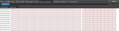

Hello I am in the task of adding a new flash as an external flash via QSPI interface with the MCU STM32F777ZITx.
The flash that I want to add is S25FL256L as an external flash. I am not finding any references which I can use with this flash. Also it is not getting clear to me whether I need to make an external loader for mapping the external flash in memory mapped mode or only configuration is needed ?

I am facing this problem where the call to the CSP_QSPI_EnableMemoryMappedMode does not fail but the external flash looks like this even after writing something
Configuration here, but blank content will be 0xFF
Unconfigured, accesses will Hard Fault. Have a Hard Fault Handler that outputs actionable information so you can diagnose / debug the situation.

You'll need an External Loader if you want the tools to download content.
To see the memory in the Debugger, etc, you'll need for your code to have successfully brought up the QSPI interface, pins, and external memory itself.
You should be able to implement read, write, and command functions to interact with the memory. Try reading the JEDEC ID and some pages first. Once you have that working you can provide this "Read Template" functionality to the Memory Mapping mode startup process, and then access to the 0x90000000 region will use that to allow the MCU to read the content.
Yours looks like the memory mapping still isn't working, and the access to 0x90000000 is faulting.
Start by reading the data/sheets and manuals for your S25FL256 memory, and get that working in your own BSP code.

I mean the confusion I have is that to view the memory map in the debugging window external loader is not needed right ?

No, but the memory needs to be up and running. It needs to be visible to the MCU to be visible in the Debugger.
The way ST does things this will be deep into main() once you've called all the functions. What *ARM* wanted was this do be done in SystemInit(), so the memory is viable for C runtime initialization and the scatter loader, so that in main() you had a nearly complete operating environment working.
In other platforms the alternative is a "Debug Script" which peeks/pokes the system and peripheral registers to bring up the clocks, GPIO, and QSPI peripheral, and the attached memory.
ST could perhaps use the Init() function of the External Loader in-lieu of the platform suitable debugger script, but I'm not sure things are at that level of sophistication a decade in.

The sum of dummy cycles and alternate byte cycles defines where the output data bits begin. The same number will be with no alternate bytes but 10 dummy cycles instead of 8.
rohan_m
rohan_mAuthor
March 8, 2024
Even with this function I am not able to enter the quad SPI transfer mode.
I still I am only using the single line mode. I think I will need to get rid of the quad mode register lock.
