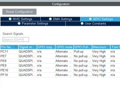

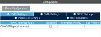

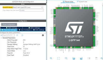

‎2024-03-06 8:32 AM
I could see this but I think this is the single line reception mode.
I still cant activate the QuadSPI
‎2024-03-06 8:41 AM
There are literally dozens of examples of bringing up the QSPI interfaces, and initial command sequences to get the devices in the correct mode.
Typically enabling the 4-pin modes as devices start with 2-pins for data in/out. This is often NOT QUAD mode, but pin related. Most frequently done via bits in the Status Register(s)
Get the device into 4-byte address mode if bigger than 16MB
Then getting them into Quad mode to improved efficiency of command / address / data transfers, but often commands that are more flexible.
Finally for memory-mapped, creating a read templated for the most efficient Read transfer method.
‎2024-03-06 8:55 AM - edited ‎2024-03-06 8:57 AM
You have to enable QUAD (pins) in Configuration Register 1, it's sticky, but you need to read it, make sure it's set and write it back.
Might want to double check the other status and configuration registers, if you use the wrong loader these can get set incorrectly, potentially write protecting blocks, or preventing erasure.
The 512Mb / 64MB device will need to get into 4-byte addressing mode, or you can use the 4-byte variants of the command to be explicit.
The part has a rich command set allowing for many possible permutations.
