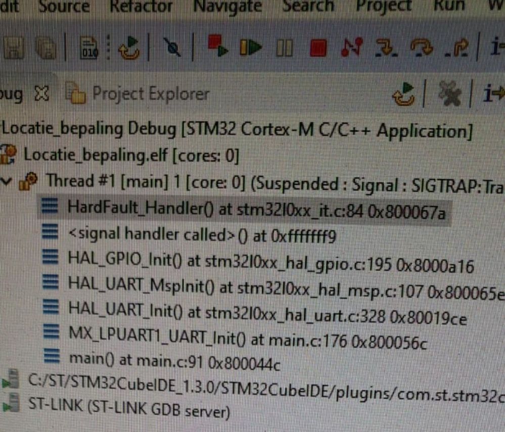

Dear fellow geek,
I am working on a project wich uses the STM32L010K4 microcontroller. We implemented the chip on a PCB and we can write pins high and low and we’re able to use SPI.
This project revolves around a GPS application. We’re trying to use the UART protocol with the stm32CubeMx IDE. We’re also trying to make some large/complex computations, I read online that this could potentially lead to stack overflow. I also read the datasheet and the uart is and spi are part of two different alternate functions. This is the message we get when trying to implement uart.
With kind regards,
Reinier Gosseling

2020-08-14 6:10 AM
Look at MX_LP_UART1_UART_Init() and ensure the LPUART1 handle is passed to everything. It should not be passing UART1 handles.
2020-08-14 11:05 PM
post your code for better help!

2020-08-15 7:04 AM
More likely to need to look at your GPIO Init code in your HAL MSP file.
The part has a finite amout of RAM, GNU/GCC will try to use all of it.
To solve Hard Fault problems you need to inspect the registers and code at and prior to the faulting location.
2020-08-19 6:23 AM
Still need to drill down to the code calling HAL_GPIO_Init()
grep or find-in-files, likely in the MSP code
Look very specifically at the REGISTERS and ASSEMBLER instructions at the faulting location, to understand what it is complaining about, likely a bad or unaligned pointer. Work back in the code to see where that was initialized
2020-08-25 4:16 AM
when using STM32L0 and getting a hardfualt, does it also has something to do with the hardware(we're trying to program a custom PCB)?
2020-08-25 4:37 AM
When implementing a stm32L0 series microcontroller in a custom PCB is it also possible that the harfault error could also have somthing to do with the actual hardware. even when some functions do work.
2020-08-25 6:41 AM
Usually hardfaults are due to software.
Examine the SCB registers to determine the cause of the hard fault and go from there.
