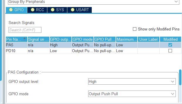

Don't pull RESETn LOW, also don't drive it with a Push-Pull Driver. Should be pulled high, and clamped low with open-drain if required.
You could also try disconnecting RESET if the part isn't starting properly.

Actually I am not using any GPIO out for RESETn to NEO M8U .
Now I have added a GPIO out pin (PA5) in STM32, which is used as RESETn and made output level as "High" as shown in figure.

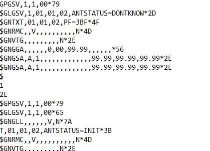

After that I am able to receive some data. But actual datas are missing.
output file is also attached.
Kindly suggest.

In a clear view of sky I am able to receive GPS data.
After fetching from NMEA sentence(GNGLL) the data is showing some 30 KM far from my location.
Output file attached.
Regards,
GBiswal
That would be more indicative of you not translating the degrees/minutes format use by NMEA into decimal degrees properly.​
Thanks.
Yes its my mistake. I was putting directly NMEA data in google map.
After converting minute to degree I am getting 4m accuracy.
