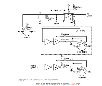

keep to the 35 y old standard:
https://www.midi.org/specifications-old/item/midi-din-electrical-specification
https://learn.sparkfun.com/tutorials/midi-tutorial/hardware--electronic-implementation

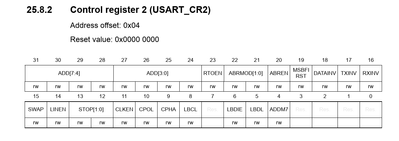

and dont forget to invert the uart output, on F373 can use:

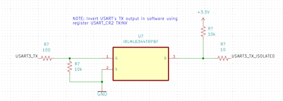

Have I wired this up correctly to isolate the STM32F373's USART TX?
yes, perfect !
