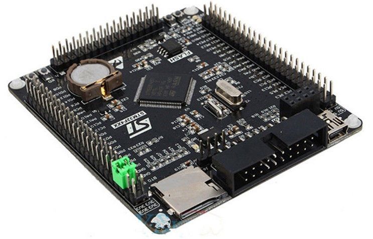

I created a new project using the GUI and after pressing the Build button, I always get below information on the Console window.
The development board I'm using is STM32F407VET6 Black Board.

Please help me with this. It has been happening since I installed the IDE to get started. Not able to even try LED blinking.

Possibly, the error could be caused by your project path. Your path contains special characters (`).
"E:\antiQue`s Stuff\Projects\STMicro Cube\ProjectOne\STM32F407VETX_FLASH.ld"
Renaming the folder might be helpful.

> -T"E:\antiQue`s Stuff\Projects
Your path contains backquote and spaces. Who actively looks for problems, gets them.

This resolved the issue.
