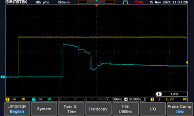

When I start work and power up the board everything works fine for a couple of minutes (let's say 5 minutes ) but later I can observe some disturbances on the reset pin... I connect the oscilloscope and I can see the voltage on the reset pin, after a few minutes of the device operating, starts to fall down slowly and there is some mess on the signal...
Here is an example waveform watched:
Yellow -> 3.3V supply
Blue -> reset line
I've tried 3 different pcs of the MCU on the same board and also try soldering bare minimum setup (LDO, MCU, caps, etc.. ) on a totally fresh PCB, and every time the same behavior...

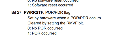

Check if the power is the origin of that reset by checking that bit:

This is the moment of powering up the board with the reset button pressed and released after about 1s...
As You can see it seems not to be related to the power supply...
Monitor PWR RST flag..

I'm not able to read any register because the board is in hardware reset condition.
Interesting fact that if I force the reset line to VDD it operates fine...
