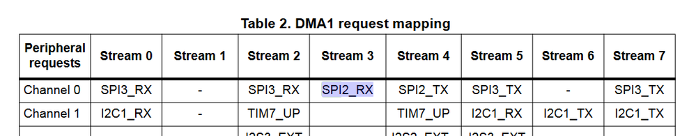

Posted on June 20, 2016 at 13:45
Thanks for your pronpt reply.
But when i enable the SP2 Nvic interrupt, nothing changes.
The DMA interrupt  : void DMA1_Stream3_IRQHandler(void)  Is never called.
And the Tx dma works.
I check in the datasheet, and the I2S_rx  only works with DMA1 stream3 channel 0 .
I don't know what is wrong !
Also, something is realy strange , when i remplace SPI2 by SPI3. It's works.
I2S3_Ext_RX with DMA1_stream0 and SPI3_TX DMA1 stream 5, both generate DMA interrupts when the i2s flow is started with the function : ''HAL_DMAEx_MultiBufferStart_IT ''
(whitout SPi3 nvic interrupt enable)
The problem is, I can't change my hardware. I need to use I2S2_ext.
Does I2S2 doesn't support full duplex mode ?
The spi2 and sp3 are configured in the same way? I don't find any  differencies in the reference manual.
Do you have an idea ?
 Thanks
