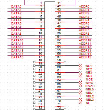

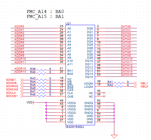

I would like to expand the external memory using the STM32F429's FMC Controller.
I want to connect BANK-1 to FPGA(like SRAM) and SDRAM bank(1 or 2) to SDRAM.
Is it possible to use FPGA and SDRAM ?
- sdram interface signals
- FPGA interface signals
