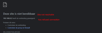

@WilliamVR wrote:
 it refuses the connection.
What do you mean, "refuses" ?
Do you get an HTTP 4xx failure status?
https://en.wikipedia.org/wiki/List_of_HTTP_status_codes#4xx_client_errors
I'll if I can get in touch.
Thats what im currently trying. But im new to freertos so its not exactly printing eveything just yet :).
Well Chrome is being a bit vague, I get this:
so there is probably an error somewhere with the TCP transmission.
I think ERR_CONNECTION_REFUSED is probably at the TCP layer - so it's not even getting to your webserver?
Yes,
Its in Dutch but I translated:
this is with me trying:
I have aslo tried just the IP adres or the 404 from the github code.

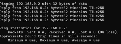

I can ping my controller tho, so it doesn't crash.
Ping is UDP - so could well get through when TCP is refused ...
